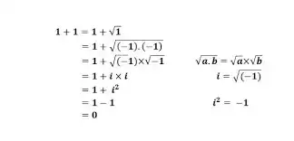

Whenever I start to get cocky about my math knowledge, some basic property of the complex plane puts me back in my place. I just came across this fake proof that 2 = 0:
In the shallowest sense, I think I know what the problem is here. The author deceptively exploits how squaring is a 2-to-1 mapping on $C \setminus 0$, and flips the sign of a root somewhere. If we use $-i$ as the square root of $-1$ instead of $i$, we get a tautology rather than a contradiction.
But what I'd like is a fuller description of the phenomenon underlying the trick. My guess is that the proof smuggles in some special property of $R$ that is so basic that the naive reader assumes it holds in $C$, even though it doesn't. Could anyone state what this property is? Is my guess on the right track?

    Square roots of negative numbers are not uniquely defined – J. W. Tanner Oct 07 '20 at 20:47
  • $\sqrt {ab} = \sqrt a \sqrt b$ only when both a, b are not both negative. – amWhy Oct 07 '20 at 20:56
  • I don't know if I would describe "using an invalid justification" as "smuggling in a special property." I think it would not go over well. – rschwieb Oct 07 '20 at 21:03
    "My guess is that the proof smuggles in some special property of R that is so basic that the naive reader assumes it holds in C. Could anyone state what this property is?". That square roots are uniquely defined. $\sqrt{x^2}\ne (\sqrt{x})^2$ unless $\sqrt{x^2} = x$. If $\sqrt{x^2}\ne x$ then $(\sqrt x)^2 = x \ne \sqrt{x^2}$. And $\sqrt{1}\ne -1$. – fleablood Oct 07 '20 at 21:12
The proof tacitly assumes that there is a function $sqrt:\mathbb{C}\rightarrow\mathbb{C}$ (which it calls "$\sqrt{\cdot}$") with the following two properties:
A: $sqrt$ gives square roots: for all $z$ we have $sqrt(z)^2=z$.
B: $sqrt$ distributes over multiplication: for all $z_0,z_1$ we have $sqrt(z_0)\cdot sqrt(z_1)=sqrt(z_0\cdot z_1)$.

The proof asserts that $$1+\sqrt{(-1).(-1)}=1+\sqrt{-1}\sqrt{-1}$$ for the reason that $$\sqrt{a. b}=\sqrt a\times\sqrt b.$$
This is wrong. The equation $\sqrt{a. b}=\sqrt a\times\sqrt b$ does not hold for all complex (or even all real) numbers $a$ and $b$. In particular, it doesn’t hold when $a=b=-1$, which is where it is incorrectly used.
