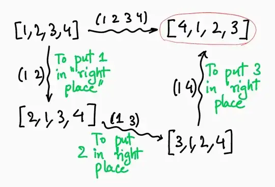

We'll write $ ``\, [k_1, \ldots, k_n] \stackrel{\sigma}{\rightsquigarrow} [l_1, \ldots, l_n]"$ to mean $`` \, [l_1, \ldots, l_n] = \sigma * [k_1, \ldots, k_n]" $.
Example 1. Cycle $ (1 \, \, 2 \, \, 3 \, \, 4) = (1 \, \, 4) (1 \, \, 3) (1 \, \, 2) $. It's easy to check this is true, but here is one way we can come up with the decomposition :
So $$ (1 \, \, 2 \, \, 3 \, \, 4)*[1,2,3,4] = (1 \, \, 4)*\bigg( (1 \, \, 3) * ( (1 \, \, 2) * [1,2,3,4]) \bigg)$$
i.e.
$$(1 \, \, 2 \, \, 3 \, \, 4)*[1,2,3,4] = (1 \, \, 4) (1 \, \, 3) (1 \, \, 2) * [1,2,3,4] $$
i.e.
$$ (1 \, \, 2 \, \, 3 \, \, 4) = (1 \, \, 4) (1 \, \, 3) (1 \, \, 2) $$
This suggests in general $ (a_1 \, \, a_2 \, \, \ldots \, \, a_k) = (a_1 \, \, a_k) (a_1 \, \, a_{k-1}) \ldots (a_1 \, \, a_2) $, which is readily verified to be true.

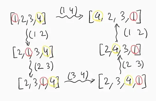

Example 2.
So
$$ (1 \, \, 4) = (1 \, \, 2) (2 \, \, 3) (3 \, \, 4) (2 \, \, 3) (1 \, \, 2) $$
Similarly in general any transposition is a product of an odd number of "elementary transpositions" [i.e. transpositions of the form $ (j \, \, j+1) $]
