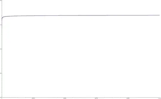

I believe that $$\lim_{n\to\infty}\,\frac{a_n}{\sqrt{2n}}=1\,.$$ In fact, this should also be true: $$\lim_{n\to\infty}\,\big(a_n-\sqrt{2n}\big)=0\,.$$ Oscar Lanzi proved these equalities in another answer. I expect, however, that $$a_n=\sqrt{2n}+\mathcal{O}\left(\frac{1}{\sqrt n}\right)\,.$$ Below is the plot of $\sqrt{n}\,\big(a_n-\sqrt{2n}\big)$ versus $n$ ($n$ runs from $1$ to $10^6$). (This conjecture is proven to be wrong by Oscar.)

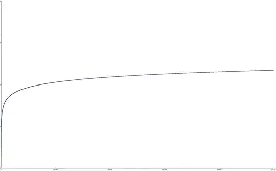

Perhaps, the conjecture above is not quite correct. Maybe, this is a better claim: $$a_n=\sqrt{2n}+\mathcal{O}\left(\frac{\ln(n)}{\sqrt n}\right)\,.$$ Below is the plot of $\dfrac{\sqrt{n}}{\ln(n)}\,\big(a_n-\sqrt{2n}\big)$ versus $n$ ($n$ runs from $1$ to $10^6$). It appears from this plot that $$a_n\approx\sqrt{2n}+\frac{1}{4\sqrt2}\,\left(\frac{\ln(n)}{\sqrt n}\right)+\mathcal{O}\left(\frac1{\sqrt{n}}\right)\,.$$ (This conjecture is proven to be right by Oscar, and the asymptotic behavior above is true regardless of the initial value $a_1>0$.) This approximation is quite good (e.g., it says $a_{75}\approx 12.336$, while the actual value is $a_{75}\approx 12.324$).
