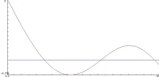

First an approximate picture of $\,\displaystyle f(x):=\sum_{n=1}^{\infty}\frac{\sin \left(\sqrt{n}\,x\right)}n\,$ for $\displaystyle\,x\in\left(\frac 1{10},10\right)$ :
0.1-10 picture (the oscillations increase quickly at the right) $$-$$ We could continue by observing that $\;\displaystyle f''(x)=-\sum _{n=1}^{\infty }\sin \left(\sqrt{n}x\right)\;$ and see what was done for $x=1$ or follow this neat thread but I'll rather try the Euler–Maclaurin formula proposed by Mark Viola to get an actual asymptotic expansion at zero.
