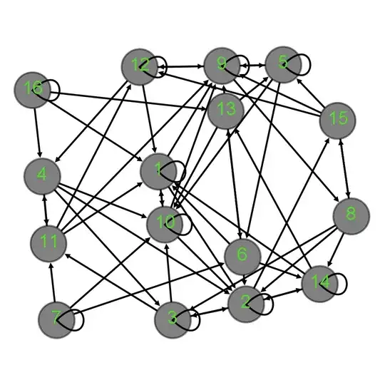

This directed graph has constant out-degree 4, some self-loops, und looks like this: Graph on 16 vertices
