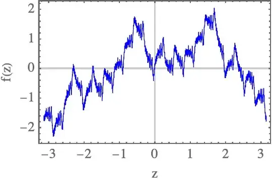

More generally, we can try to plot the function $$ f(z) = \sum_{k=1}^{\infty} \frac{\sin(k(k+z))}{k} $$ where $s_1=f(-1)$ and $s_2=f(0)$: this function seems to have a lot of structure,
