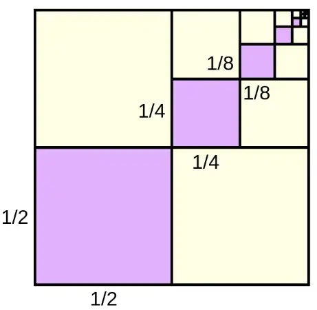

A simple but effective way to see how the sum of infinitely many terms can converge to a finite number is the following geometric series
$$\sum_{n=1}^\infty \left(\frac14\right)^n$$
and its geometric visualization as a infinite sum of squares, from which we can see that the value for the series must be less than a finite quantity since it is contained into a unitary square
(credits)
