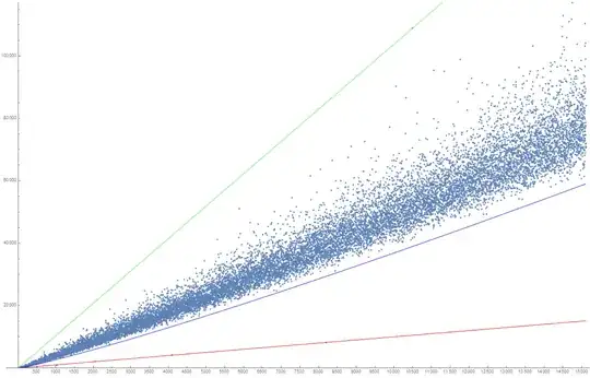

Here is the plot of around first $15000$ terms of $a(n)$:
The red line below is $y=x$ and intersects $n=2^m$'s since $a(2^m)=2^m$.
All the other terms are above the blue line which is $y=x^{1.14}-4$, an exponential lower bound that I guessed holds so far.
The green line intersects the origin $(0,0)$ and the term $a(10496)=108893$, which is the farthest term from the average so far. We have $10496=2^8\cdot 41$.
$(Q_1)$ Can we prove all terms $a(n)$ will be finite? For fixed $n$ the jumping must be periodic eventually, but will that period contain every $s$?

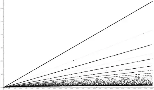

That is, we look at $R(1,n)$ values, and it appears that it is $\approx n/l$, for some $l\in\mathbb N$.
  • if $n=p$ is prime, then $R(1,p)\approx n/2$, to be precise: ($\delta\in\mathbb N$ depends on exact $n$)
$$R(1,p)=\frac12(n+1)+\delta$$
  • if $n=2p$ where $p$ prime, then $R(1,2p)\approx n/4$, to be precise: ($\delta\in\mathbb N$ depends on exact $n$)
    $$R(1,2p)=\frac14(n+2)+\delta$$
  • if $n=2^m q$ where $q$ is odd, then $R(1,2^m q)\approx n/q$.
Depending on $l$ value, we get terms $R(1,n)$ accumulating around lines $y=x/l$.
Notice how odd $l$ are rarely populated, and how even $l$ are dense.
For example, as already mentioned, primes gather around $l=2$, and even semiprimes around $l=4$. For an odd $l$ example, it seems the numbers of form $2^m\cdot 3$ belong to $l=3$.
$(Q_3)$ Can we find a closed form for $R(1,n):=$ $k$-step at which we make the first $R$ jump?
