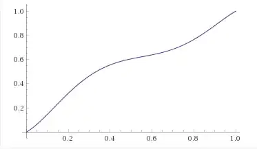

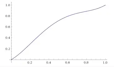

When $c = 2,$ $$ f(x) = x + \frac{27x^2(1 - x)^2(2 - 3x)}8. $$ From Wolfram Alpha:
c = 2

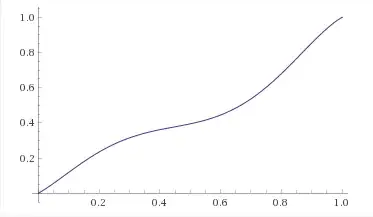

When $c = \tfrac12,$ $$ f(x) = x + \frac{27x^2(1 - x)^2(1 - 3x)}8. $$ From Wolfram Alpha:
c = 1/2

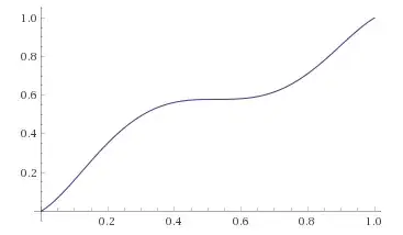

Dropping the constraint $f'\left(\frac1{c + 1}\right) = 1$ simplifies the formula somewhat: $$ f(x) = x + \frac{(c^2 - 1)(c + 1)^2x^2(1 - x)^2}{2c^2}, $$ but this doesn't greatly increase the range of usable values of $c.$ Also, the graphs take on a squashed appearance when $x$ approaches $1,$ as this example for $c = 2$ illustrates:
c = 2 (constraint removed)

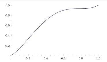

The graph for $c = 5/2,$ although still monotonic - unlike \eqref{3339606:eq:1}, in this case - is even worse:
c = 5/2 (constraint removed)

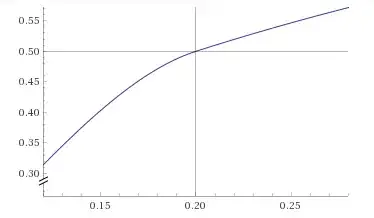

Here is a closer look at the knot of that spline function:
c = 4 (cubic spline), in the region of the knot.

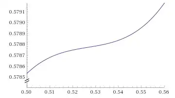

The graph of $f_c$ for $c = c_0$ looks like this:
c = c_0.
Here is a close-up view of the flattest part of that graph:
c = c_0, close-up view.

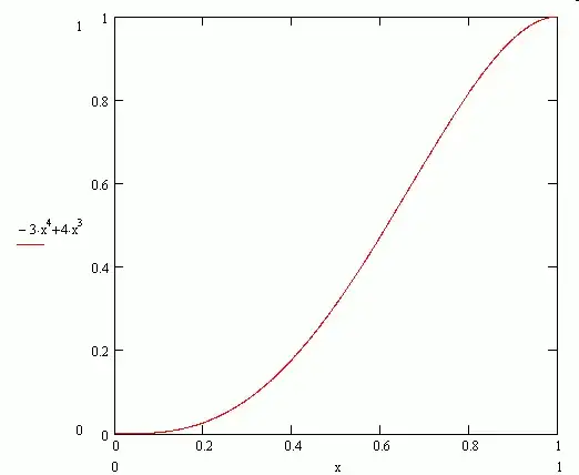

Assume that $f$ is a polynomial of fourth degree. Then $f’(x)$ is a cubic polynomial such that $f’(x)-f’(0)$ has two roots $0$ and $1$. Thus $f’(x)=f’(0)+ax(x-1)(x+b)$ for some real $a$ and $b$. An equality $1=f(1)-f(0)=\int_0^1 f’(x)dx$ implies $f’(0)=1+\tfrac a{12}(2b+1)$. The monotonicity of $f$ is equivalent to $f’(x)\ge 0$ at $[0,1]$. The latter holds iff $f’(0)\ge 0$ and $f’(x_m)\ge 0$ for each local minimum $x_m\in (0,1)$ of the function $f$. Since $f’’(x_m)=0$, $3x_m^2+2(b-1)x_m-b=0$, that is $x_m=\tfrac{1-b+r}3$, where $r=\pm \sqrt{b^2+b+1}$. Since $f’’’(x_m)=6ax_m+2a(b-1)=2ar$ and $x_m$ is a point of a local minimum, we have that $r$ and $a$ have the same sign. We also need $x_m\in [0,1]$, that is $b-1\le r\le b+2$. It is easy to check that this is equivalent to $b\ge -1$, if $a>0$, and to $b\le 0$, if $a<0$. Unfortunately, I don’t see an easy way to find a range of $c$ for which there exists $f$ satisfying the above sconditions such that $f\left(\tfrac 1{c+1}\right)=\tfrac 12$. We can illustrate $f$ for $a=-12$ and $b=0$. Then $f(x)=-3x^4+4x^3$ and $f^{-1}\left(\tfrac 12\right)\approx 0.614$.
