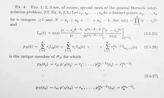

I'm trying to use Example 4 in Section 2.5 of Philip J. Davis's book Interpolation and Approximation (Dover 1975). The aim is to fix an error in an answer I posted last night. This gives the problem a certain urgency, otherwise I would struggle on until light dawns! (If I don't get anywhere with the book, I'll try to follow this answer by joriki instead.)
Davis (1975), Section 2.5, Example 4
I'll translate Davis's notation into the notation I'm using for the other problem, then specialise down to the case that's needed. This is almost a case of "simple" Hermite interpolation, except that for exactly one of the $n$ interpolation points, no derivative value is specified. (The derivative is zero at all the other $n - 1$ interpolation points, which ought to simplify things.)
Let $x_1, x_2, \ldots, x_n$ be distinct real numbers, $\alpha_1, \alpha_2, \ldots, \alpha_n$ positive integers, and $N = \alpha_1 + \alpha_2 + \cdots + \alpha_n - 1$. In the case of particular interest, there is a single index $i$ such that $\alpha_i = 1$ and $\alpha_j = 2$ for all $j \ne i$, so $N = 2n - 2$.
Deviating slightly more (still not harmfully, I hope) from Davis's notation, set: \begin{gather*} w_j(x) = \prod_{\substack{k=1\\k\ne j}}^n(x - x_k)^{\alpha_k} \quad (1 \leqslant j \leqslant n), \\ l_{jm}(x) = \frac{(x - x_j)^m}{m!}w_j(x)\frac{d^{(\alpha_j-m-1)}}{dx^{(\alpha_j-m-1)}}\left[\frac{1}{w_j(x)}\right]_{x=x_j} \quad (1 \leqslant j \leqslant n; \ 0 \leqslant m < \alpha_j), \\ p(x) = \sum_{j=1}^n\sum_{m=0}^{\alpha_j-1}r_j^{(m)}l_{jm}(x), \end{gather*} so that $p$ is a polynomial of degree $N$, constructed from $N + 1$ given real numbers $r_j^{(m)}$. The claim is: $$ p^{(m)}(x_j) = r_j^{(m)} \quad (1 \leqslant j \leqslant n; \ 0 \leqslant m < \alpha_j). $$ This is clearly equivalent to: $$ l_{jm}^{(q)}(x_k) = \delta_{jk}\delta_{mq} \quad (1 \leqslant j, k \leqslant n; \ 0 \leqslant m, q < \alpha_j), $$ where $\delta$ is the Kronecker delta.
In our special problem, $r_{j}^{(1)} = 0$ for all $j \ne i$ (and $r_i^{(1)}$ isn't defined).
Making matters even simpler, we have $r_j^{(0)} = 1$ for all $j \leqslant i$, and $r_j^{(0)} = 0$ for all $j > i$. Therefore: $$ p(x) = l_{10}(x) + l_{20}(x) + \ldots + l_{i-1,0}(x) + l_{i0}(x). $$ The last term in this sum, at least, presents no problem: $$ l_{i0}(x) = w_i(x)\frac{d^{(0)}}{dx^{(0)}}\left[\frac{1}{w_i(x)}\right]_{x=x_i} = \frac{w_i(x)}{w_i(x_i)} = \prod_{\substack{j=1\\j\ne i}}^n\left(\frac{x-x_j}{x_i-x_j}\right)^2. $$ This only has to satisfy $l_{i0}(x_j) = \delta_{ij}$ ($1 \leqslant j \leqslant n$), and it does.
The reason I am posting this question is that I cannot understand why the terms for $j \ne i$: $$ l_{j0}(x) = w_j(x)\frac{d}{dx}\left[\frac{1}{w_j(x)}\right]_{x=x_j} $$ satisfy the conditions $l_{j0}(x_k) = \delta_{jk}$ ($1 \leqslant k \leqslant n$). This does not seem evident from the definition, nor does it become any more evident when I write out the form of $l_{j0}(x)$ in the special case at hand.
In the present problem: $$ w_j(x) = (x - x_i)\prod_{\substack{k=1\\k\ne i,j}}^n(x - x_k)^2 \quad (j \ne i). $$ But it seems clearer to describe the problem in the general case, because there we have simply: $$ l_{j0}(x) = w_j(x)\left[-\frac{w_j'(x)}{w_j(x)^2}\right]_{x=x_j} = -\frac{w_j'(x_j)}{w_j(x_j)}\frac{w_j(x)}{w_j(x_j)}, $$ therefore: $$ l_{j0}(x_j) = -\frac{w_j'(x_j)}{w_j(x_j)}, $$ and this is not always equal to $1$. (We do, however, have $l_{j0}(x_k) = 0$ for all $k \ne j$.)
I expect my mistake is equally simple, but what is it?
