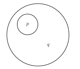

As an example, I commonly see this picture used to explain implication if $p$ then $q$ propositions:
implication
Which, on its own, makes perfect sense. But I fail to see how this picture also represents $\neg p \lor q$, which is an equivalent form of $p \rightarrow q$. (As confirmed by truth tables)
If anything, the space "not $p$" would just be $q \land \neg p$...and therefore $\neg p \lor q$ would just be $(q \land \neg p) \lor q$...which is just $q$. But that means that $p \rightarrow q = q$...and that cannot be right, can it? That's sort of like modus ponens but missing the second step of decalring that $p$ is true.
Regardless, I'm clearly not thinking about this subject in an effective way so if anyone can offer insight, I'd greatly appreciate it!

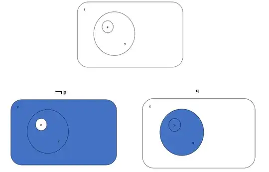

Edit: I am adding some pictures to clarify some confusion:
Answers offered below have made me realize that the picture previously provided is incomplete. There should exist another set, call it $E$ (for Everything) that contains, in addition to q, everything outside of q. This changes my understanding of what $\neg p$ means...but questions nonetheless remain.
$\neg p$ and $q$ are therefore illustrated as follows:
not p and q within E illustration
Therefore, $\neg p \lor q$ looks like this:
everything true
To me this means that every element in the universe satisfies the proposition of $\neg p \lor q$...which by equivalence, means that every element in the universe satisfies the proposition $p \rightarrow q$. Could I have further clarification?

If anything, the space "not $p$" would just be $q$.
No, $\lnot p$ is the region outside the inner disc — that is everything that is not inside the inner disc – which includes part of the outer disc and everything outside of it.
$q$ is the region inside the outer disk.
$\lnot p\vee q$ is the union of both regions, which we are claiming is everything.   The diagram agrees, since at least one of the following statements is guaranteed for any point at all: (1) it is not on the inner disc, or (2) it is on the outer disc.
  • Any point on the inner disc is on the outer disc (it is $q$).
  • Any point outside both disc is not on the inner disc (it is $\lnot p$).
  • Any point between is both.
  • That covers all points on the diagram; so it matches the claim: $\lnot p\lor q$ .
And of course, if a point is on the inner disc, then it is on the outer disc. (The inner disc is a subset of the outer disc.)   Thus the diagram corresponds to $p\to q$ too.

  • Oh, sorry about that. I meant to say q complement p. I’ll make the edit. Nonetheless, doesn’t “q complement p OR q” still equal q? – S.C. Aug 08 '19 at 02:26
    "q complement p OR q" is not a well formed statement. Are you aiming for the equivalent of set difference? Because, indeed, $(q\land\lnot p)\lor q = q$ (in general, not just on this diagram). – Graham Kemp Aug 08 '19 at 02:29
  • Do complements not exist in propositional logic? – S.C. Aug 08 '19 at 02:31
  • Ohhhh, so even if I had written it as the set difference, I would have been wrong. I am not factoring in what exists “outside the boundary” of q. Got it! – S.C. Aug 08 '19 at 02:35
    The analogue for complement is negation. The analogue of relative complement (aka set difference*) is conjunction with a negation $(q\land\lnot p)$. – Graham Kemp Aug 08 '19 at 02:35
  • I just want to confirm that I am understanding your comments correctly. You say that not $p$ is equal to the portion of $q$ that is not occupied by $p$ AND everything outside of $q$. If I union this new space with $q$, I will get EVERYTHING (i.e. everything within $q$ and everything outside of $q$). How can this ‘infinite space’ be equal to the confined space that is occupied by $ p $ implies $q$ – S.C. Aug 08 '19 at 02:49
  • For any point on your diagram, the statement: "if the point is on the inner disc, then it is in the outer disc" is true. (Implications are considered false only when the antecedent is true yet the consequent if false; there is nowhere on the diagram that happens.) – Graham Kemp Aug 08 '19 at 03:42
  • if you're willing, I added some details to my question (pictures) that are aimed at addressing my confusion between this equivalence...because I'm clearly misunderstanding something. – S.C. Aug 08 '19 at 13:36
