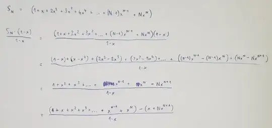

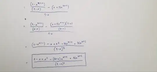

Here's what I did to get the formula for partial sums of this series:
It was too much to type in LaTeX, so just did it on paper. Hope you don't mind.
KKZiomek
  • 4,012
  • Thank you! Could you please explain how you know to add the (1 - x) / (1 - x) to the series? – Joon Mar 17 '19 at 16:31
    @Joon it's just a clever trick. There's really no reason why would one multiply and divide by (1-x). I guess it just works :) – KKZiomek Mar 17 '19 at 17:15
    If you analyze it closely you see that it cleverly cancels out like terms in a fashion that creates a geometric sequence. So I guess to know to multiply by (1-x) you have to observe and be clever. I didn't come up with this method. I found it in some paper about sequences long time ago – KKZiomek Mar 17 '19 at 17:17
    Thank you again, I could understand your method and follow along. Really appreciate it – Joon Mar 17 '19 at 17:23
