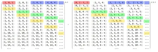

Proof Visualization
Where the first matrix represents $(a,b,a)_{B+t}$ forms as elements, and the second matrix represents those forms in base $B+t+1$. (Where $B$ is the smallest base so that the absolute forms make sense.)
Colored in yellow is the case $b=2a$ from the proof, above it are the third case, and below it are the first case elements.
Colored in green is the first set of $f_3$ solutions we find in the proof, and colored in blue is the second set of $f_3$ solutions we find in the proof.
Looking at green examples, you can see in the right table that the form is absolute and they're clearly $f_3$ solutions. Looking at blue examples, you can see that we do not have a direct absolute form. That's why we needed to go into more subcases and consider what happens when number base is or is not large enough.
Colored red is the only "unimportant" $f_3$ solution, the $10=(1,0,1)_3=(2,2)_4$ that obviously does not extend to $F_3$.
Then to extend $f_3$ to $F_3$, we observe the third table (that is not included) for base $B+t+2$.
