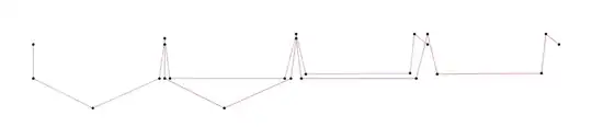

Experiments by several users drawing polygonal paths in GeoGebra [other programs are available!] have so far failed to produce a counterexample to the conjecture (expressed in the "weaker" form). Here is a failed attempt for $n = 3$ (illustrating the main form of the conjecture in this question):
Failing to construct a counterexample with n = 3.
It's a racing certainty that someone will now produce a counterexample with embarrassing ease. :)
