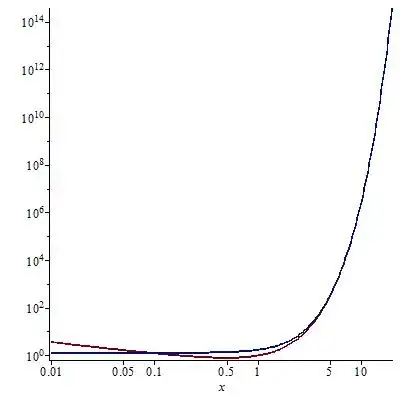

To have a clear idea, in the range $\kappa=0.01\ldots 20$, I plotted the following log-log graph.
I should say that the agreement is excellent. The red curve is the exact one. I hope this will be of some help to you.
