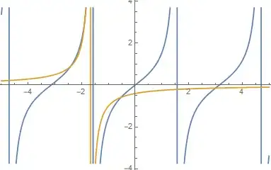

As part of an engineering problem, I've been trying for a generic solution for $(a\cdot x+b)\cdot \sin(x)+c\cdot \cos(x)=0$
Here's something I tried:
$(a⋅x+b)⋅\tan(x)+c=0$, when $\cos(x)\neq 0$ $$\tan(x)=\frac{-c}{a⋅x+b}$$ It sort of looking like this, when, say, $a=2, b=3, c=5$:a=2, b=3, c=5
Any chance that can be solved without using numerical methods?
EDIT: I was looking for solutions in the form of $x \approx f(a,b,c) $, preferably finding solution in any range, because $a$, $b$, and $c$ can take wierd values. It's used for a program where it will not be trivial to solve problem procedurally.

There's no closed form solution for that equation, so numerical methods are required.
That said, you can come up with estimates for the solutions towards $\pm \infty$. For instance, as $n\rightarrow +\infty$, if you write the solutions as $x_n=n\pi + u_n$, with $u_n\in (-\frac \pi 2, \frac \pi 2)$, then $$\tan x_n = \tan u_n = \frac {-c}{ax_n+b}\tag{1}=-\frac c {an\pi + a u_n + b}$$ Because the right-hand side of that equation is equivalent to $-\frac c {a\pi n}$, we must have that $\tan u_n\rightarrow 0$, which means that $u_n\rightarrow 0$. Plugging that information back into (1) yields $$u_n=-\frac c {a\pi n} + v_n$$ where $v_n = o(\frac 1 n)$. And you can now plug this back, again, into (1), and find an estimate for $v_n$. And you keep doing that ad lib to find higher order estimates in the solution $$x_n = n\pi -\frac c {a\pi n} + ....$$

Besides numerical solutions for particular parameter values, you could try series solutions. Thus when $c$ is small compared to $a$ and $b$, the solution near $x=0$ is
$$ -\frac{b}{a} + \cot\left(\frac{b}{a}\right) \frac{c}{a} + \cot\left(\frac{b}{a}\right) \csc^2 \left(\frac{b}{a}\right) \frac{c^2}{a^2} + \left(\cot^3\left(\frac{b}{a}\right) + \cot\left(\frac{b}{a}\right) \sec^4 \left(\frac{b}{a}\right)\right) \frac{c^3}{a^3} + \ldots $$
