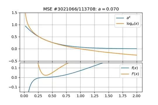

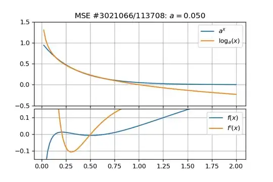

I found this problem interesting and I numerically investigated it a bit deeper. This led me to another question. Figures below show that such roots exist and are reals:
enter image description here enter image description here enter image description here
And roots can be computed numerically for several values of $a$:

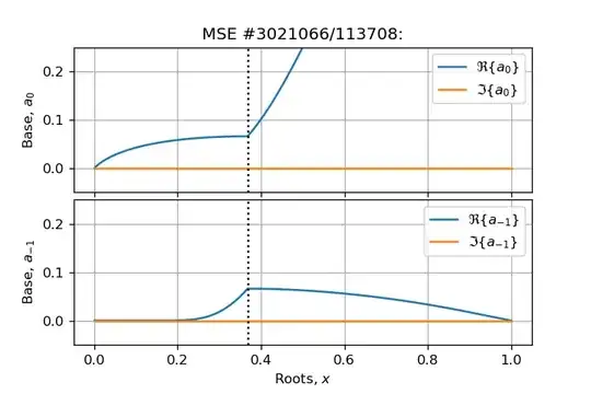

  4. Solving the original problem is equivalent to solve (base conversion and Lambert W properties):$$\ln(a) = \frac{W\left(x \ln(x)\right)}{x} = \frac{\ln(x)}{x} \Leftrightarrow a_k = \exp\left[\frac{W_k\left(x \ln(x)\right)}{x}\right]$$
  5. Roots become triple when $a < e^{-e}$ (dashed black vertical line, as shown by Claude Leibovici in his answer)
  6. Roots have asymptotic behavior, it can be checked in term of $a(x)$ for two branches:
    • one root tends to unity as $a\rightarrow 1$: $\lim\limits_{x\rightarrow 1} a = 1$ (green curve rightmost);
    • two roots tend to zero as $a\rightarrow 0^+$: $\lim\limits_{x\rightarrow 0^+} a = 0$ (green and orange curves leftmost).

Considering the function $$f(x)=a^x-\frac{\log (x)}{\log (a)}$$ its derivatives are $$f^{(n)}(x)=a^x \log^n(a)+(-1)^n \frac{(n-1)!}{x^n\, \log(a)}$$ The first derivative cancels at two points given by $$x_1=\frac{W_0\left(\frac{1}{\log (a)}\right)}{\log (a)}\qquad \text{and}\qquad x_2=\frac{W_{-1}\left(\frac{1}{\log (a)}\right)}{\log (a)}$$ which, in the real domain, exist if $\frac{1}{\log (a)}\geq -\frac 1 e$ that is to say if $a \leq e^{-e}$. If this is the case, $f(x_1)<0$ and $f(x_2)>0$ which explains the three roots.
What is interesting is to look at what happens when $a = e^{-e}$. For this value, the solution of $f(x)=0$ is unique $x=\frac 1e$. At this point, the second derivative is also zero and the Taylor expansion is $$\frac{e^2}{6} \left(x-\frac{1}{e}\right)^3-\frac{5e^3}{24} \left(x-\frac{1}{e}\right)^4+O\left(\left(x-\frac{1}{e}\right)^5\right)$$ which makes that, at ths point, $x=\frac 1e$ is a triple root of the equation.
On another side, we could also solve the equation for $a$ and its solutions are given by $$a_1=\left(\frac{x \log (x)}{W_{0}(x \log (x))}\right)^{\frac{1}{x}}\qquad \text{and}\qquad a_2=\left(\frac{x \log (x)}{W_{-1}(x \log (x))}\right)^{\frac{1}{x}}$$ which do exist if $x \leq \frac 1e$. These two functions are worth to be plotted.
When $x \to 1$ the expansion of $a_1$ is $$a_1=1+(x-1)-(x-1)^2+\frac{1}{2} (x-1)^3+O\left((x-1)^4\right)$$ and using series reversion $$x= 1+(a_1-1)+O\left((a_1-1)^2\right)$$ making that if $x\to 0 \implies a_1 \to 0$.
