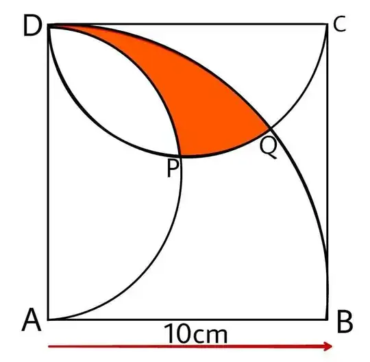

This is a popular problem spreading around. Solve for the shaded reddish/orange area. (more precisely: the area in hex color #FF5600)
find area dpq
$ABCD$ is a square with a side of $10$, $APD$ and $CPD$ are semicircles, and $ADQB$ is a quarter circle. The problem is to find the shaded area $DPQ$.
I was able to solve it with coordinate geometry and calculus, and I verified the exact answer against a numerical calculation on Desmos.

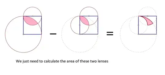

The area is equal to difference between the area of two lenses.
It is easy to find the area of lenses like the one I did in this question before: How to find the shaded area enter image description here

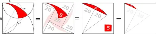

The answer is $5+\frac34 (10^2\arctan(\frac12)-40) = 75\arctan(\frac12)-25 =\pm9.774$.
First I divided the large square in five equal areas of twenty (see image). A part of our shape occupies one fourth of the smaller central square with area 20. The remaining part of our shape consists of half a lense with radius 10 (A), minus a scaled copy of that lense with radius 5 (B). Hence the remaining part of our shape is $\frac34$ of area A.
Area A is obviously a circle segment with area $\frac{2\arctan(\frac12)}{2\pi}\times \pi 10^2 $ minus a triangle of area $40$. $\blacksquare$

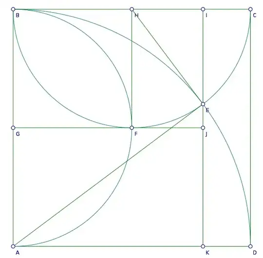

If you add area of blue circle slices and subtract area of green shapes you'll get the area of the shape you want.
schematic
You (trivially) know the area of green shapes.
And you know the size of blue areas because by looking at triangles you can find out that the angles are $2 \ atan \frac{1}{2}$ (larger one) and $\frac { \pi } { 2 } - 2\ atan \frac{1}{2}$ (smaller one).
You just need to divide the angles by $2\pi$ and multiply by area of respective full circles.
The response is:
$$ Area = 100\ (\frac {2\ atan \frac 1 2} { 2 \pi }\pi + \frac { \pi - 2\ atan \frac 1 2} {2\pi} \frac \pi 4 - \pi/16 - 1/4) $$ $$ Area = 100\ (atan \frac 1 2 + \frac { \pi - 2\ atan \frac 1 2} {8} - \pi/16 - 1/4) \approx 9.7735707 $$
PS. I found this solution by trying to make geometric sense of the analytical result found using integrals.
image to the solution

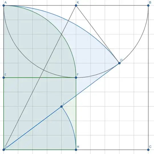

The area can be expressed through rectangles, rectangular triangles and sectors:
$S(BIJG)=S(BIKA)-S(GJKA)$
$S(BEI)=S(BIKA)-S(BEA)-S(AEK)$
$S(HEF)=S(HCF)-S(HCE)=S(BFG)-S(HCE)$
$S(EJF)=S(HIJF)-S(HEF)-S(HIE)=S(HIJF)-S(BFG)+S(HCE)-S(HIE)$
$S(BEF)=S(BIJG)-S(BEI)-S(BFG)-S(EJF)=$ $S(BIKA)-S(GJKA)-S(BIKA)+S(BEA)+S(AEK)-S(BFG)-S(HIJF)+S(BFG)-S(HCE)+S(HIE)=$ $-S(GJKA)+S(BEA)+S(AEK)-S(HIJF)-S(HCE)+S(HIE)$
$HI=x$, $AK=5+x$, $IE=\sqrt{25-x^2}$, $EK=\sqrt{100-(5+x)^2}$, $IK=10=\sqrt{25-x^2}+\sqrt{100-(5+x)^2} \Rightarrow$ $10-\sqrt{25-x^2}=\sqrt{75-10x-x^2} \Rightarrow$ $100-20\sqrt{25-x^2}+25-x^2=75-10x-x^2 \Rightarrow$ $50+10x=20\sqrt{25-x^2} \Rightarrow$ $5+x=2\sqrt{25-x^2} \Rightarrow$ $\sqrt{5+x}=2\sqrt{5-x} \Rightarrow$ $5+x=20-4x \Rightarrow x=3$
$S(GJKA)=5\cdot 8=40$, $S(BEA)=50\cdot \sin^{-1}(AK/AB)=50\cdot\sin^{-1}(0.8)$, $S(AEK)=(8\cdot 6)/2=24$, $S(HIJF)=3\cdot 5=15$, $S(HCE)=25/2\cdot \sin^{-1}(IE/HE)=12.5\cdot\sin^{-1}(0.8)$, $S(HIE)=(3\cdot 4)/2=6$
$S(BEF)=-40+50\cdot\sin^{-1}(0.8)+24-15-12.5\cdot\sin^{-1}(0.8)+6=$ $37.5\cdot\sin^{-1}(0.8)-25$
Tried BFI numerical sums, didn't get back to error again for the needed extra independent condition ..
