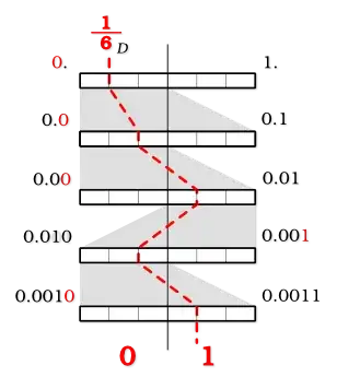

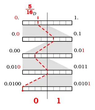

These pictures might give you some more intuition ;-) Here $\frac{5}{16} = 0.0101_B$, as the denominator is of form $2^n$, the representation is finite (process ends when you hit zero); $\frac{1}{6} = 0.0010\overline{10}_B$ as the denominator is not of form $2^n$, but the number is rational, so representation is infinite and periodic.
I hope this helps ;-)
