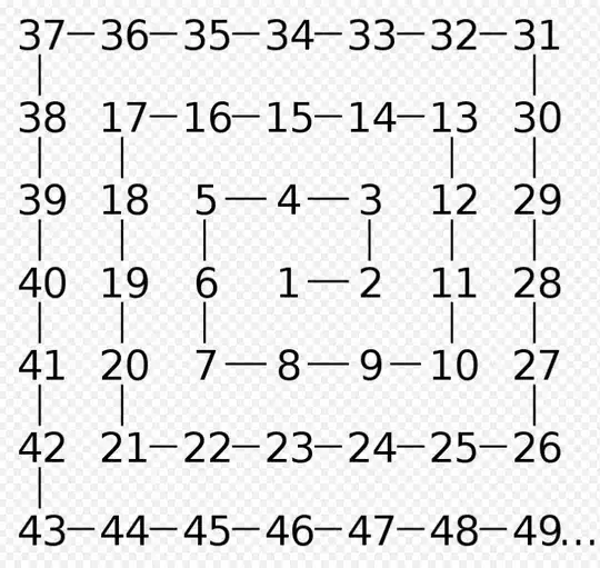

Say I have an infinte 2D grid (ex. a procedurally generated world) and I want to get a unique number for each integer coordinate pair. How would I accomplish this?
My idea is to use a square spiral, but I cant find a way to make a formula for the unique number other than an algorythm that just goes in a square spiral and stops at the wanted coords.
The application for this converstion could be for example a way to save an n dimensional shape to a file where each line represents a chunk of the shape (by using $u(x, y, z) = u(u(x, y), u(y, z))$ ), or have a very unique random seed for each integer point (ex. a way to hash an integer vector to a data point in an n dimensional array)

You can do your idea with the Ulam spiral: enter image description here The cell numbered $1$ is the origin. Note the odd squares follow the downward right diagonal and the even squares start just above $1$ and follow an upward left diagonal. If we are given a coordinate $(x,y)$ we first find the direction the side is going. If $x \gt 0, x \gt |y|$, the cell is on an upward side. The corner at the bottom is $(x,-x)$ and has number $(2x-1)^2$ The number in our cell is $y+x$ cells above, so the number is $(2x-1)^2+y+x$. You can go through the other three sides similarly. To go the other direction, given a cell number find the perfect square below it. Find the location of the square on the diagonal, then count the number of squares from there as needed.
