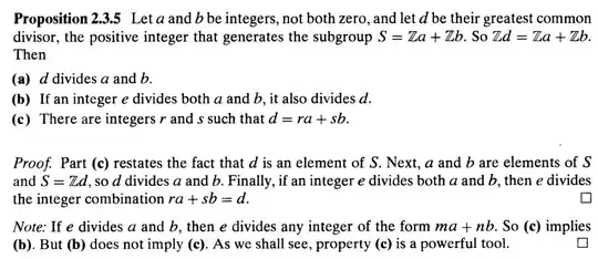

Well firstly, how do you define $\gcd(a,b)$? I'll define it by the converse of a proposition in Artin Algebra (Prop 2.3.5)
Namely, we'll prove
Converse of Prop 2.3.5: Let $a$ and $b$ be integers not both zero. Suppose (a) $d$ divides $a$ and $b$, (b) any integer $e$ that divides $a$ and $b$ also divides $d$ and (c) there are integers $r$ and $s$ s.t. $d=ra+sb$. Then $\mathbb Z d=\mathbb Z a + \mathbb Z b$.
where $d:=\gcd(a,b)$ is defined by the integer given by the assumptions of the above stated Converse of Prop 2.3.5.
Pf:
($\supseteq$)
Let $n \in \mathbb Za + \mathbb Zb$. Then there are integers $n_a, n_b$ s.t. $n=n_a a + n_b b$. We must show $n \in \mathbb Zd$, i.e. we must find an integer $n_d$ s.t. $n=n_d d$.
By $(a)$, there are integers $d_a, d_b$ s.t. $d_a d = a, d_b d = b$. Thus, $$n=n_a a + n_b b = n=n_a d_a d + n_b d_b d.$$
Thus, $n_d = n_a d_a + n_b d_b$.
($\subseteq$)
Let $n \in \mathbb Zd$. Then there is an integer $n_d$ s.t. $n=n_d d$. We must show $n \in \mathbb Za + \mathbb Zb$, i.e. we must find integers $n_a, n_b$ s.t. $n=n_a a + n_b b$.
By $(c)$, there are integers $d_1, d_2$ s.t. $d=d_1 a + d_2 b$. Thus, $$n=n_d d = d_1 a n_d + d_2 b n_d$$
Thus, $n_a = d_1 n_d, n_b = d_2 n_d$.
QED
Note: Observe the original $(c)$ is Bézout's identity, while using $(c)$ as an assumption is no longer Bézout's identity but simply that $d$ has such integer combination form.
Update: A proof without using $(c)$: https://math.stackexchange.com/a/2900969
