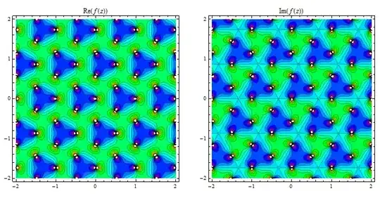

If these functions are plotted in the complex plane, a hexagonal structure similar to what is observed for the Dixon elliptic functions can be seen. This suggests that there might be a relationship between these functions and the Dixon elliptic functions.

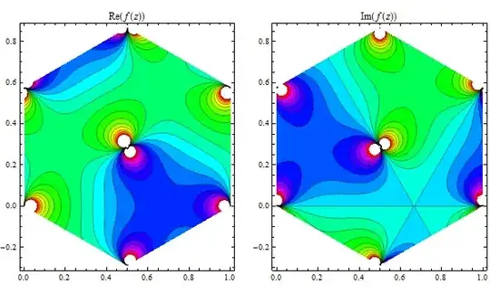

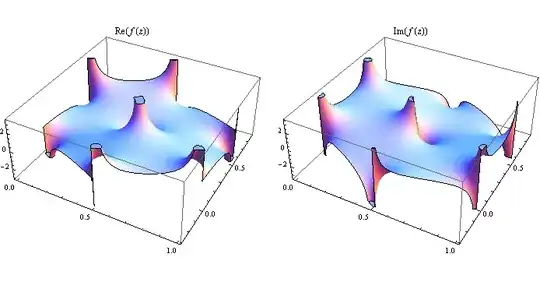

As promised, here are plots of $f(z)$ on the real line:
a contour plot of the real and imaginary parts of $f(z)$:
and plots of a single "hexagonal tile" of $f(z)$:
Plots of $g(z)$ are similar since $g(z)=f(-z)$.
