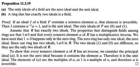

Artin has different definitions of rings particularly that his rings are unital and commutative in both addition and multiplication. Therefore, ideals are neither right nor left, afaik. (*)
In the book, Artin proves that a commutative unital ring with exactly 2 ideals is a field. (*) For non-commutative unital rings, I would like to know what we get under certain circumstances eg a non-commutative field or a division ring. Edit: Apparently, non-commutative field isn't necessarily defined as a division ring or anything at all. What I mean by non-commutative field is that we have all the properties of fields except that multiplication is not commutative.
If a commutative unital ring with exactly 2 ideals is a field, then...

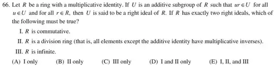

This is based on a GRE question:
I mistakenly answered $D$ instead of $B$ because I forgot that Artin defines rings to be commutative.
It appears the answer to my first question is affirmative because of Ian Coley's solution (which I think forgets to say $r \ne 0$)
I don't see how the answer to my second question would be different because $0$ and $R$ I guess are still left ideals.
Definition of ideals of a ring:
Prop 11.3.19(b) says a ring with exactly 2 ideals is a field:

Let $R$ be a (perhaps non-commutative) nonzero ring with a unit. Then the following are equivalent:
  1. $R$ is a division ring, i.e. every nonzero element has an inverse.
  2. $R$ has precisely two left ideals.
  3. $R$ has precisely two right ideals.
Proof:
  • ($1 \implies 2$) If $I \neq \{0\}$ is a left ideal, then let $a \in I$ be a nonzero element. By the division ring assumption, $a^{-1} \in R$ exists, and $1 = a^{-1} a \in RI \subseteq I$ by the fact that $I$ is a left ideal. So $1 \in I$, and $I = R$.
  • ($2 \implies 1$) Since $\{0\} \neq R$ are always ideals, for any nonzero $a \in R$, the left ideal $aR = R$. Hence there exists some $b \in R$ such that $ab = 1$.
  • The proof of $(1 \iff 3)$ is identical to $(1 \iff 2)$.
We also have the following implication: if $R$ is a division ring, then $R$ has precisely two two-sided ideals. This follows readily from the above. But the converse implication is not true: if $R$ has precisely two two-sided ideals, it may not be a division ring. For example, the matrix ring over a field has only two two-sided ideals.
Finally, if $R$ is commutative, a left ideal is a right ideal is a two-sided ideal, and so everything above is equivalent.
