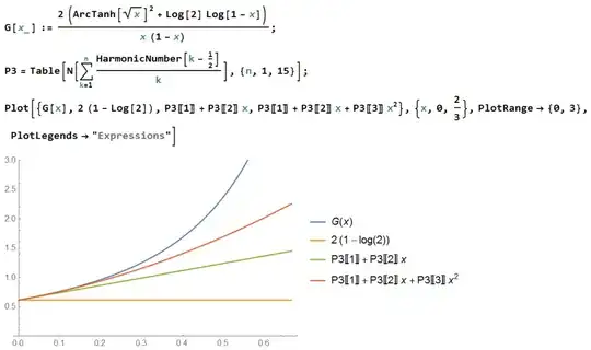

Update
With the help of Mathematica I have derived the following simple closed form for the generating function:
$$G(x)= \frac{2}{x(1-x)} \left( \operatorname{arctanh}^2 \sqrt{x}+\log 2 \log (1-x) \right)$$
I have checked a few derivatives and it works.
Note:
$$p_3(n+1)= \frac{1}{n!} \lim_{x \to 0} \frac{\partial^n}{\partial x^n} G(x)$$
Here's an illustration:
