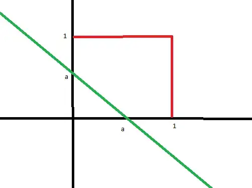

I would like to to first try go about doing it without using convolution, as André Nicholas recommends here. So I make a sketch:
Where the green line represents $x+y=a$

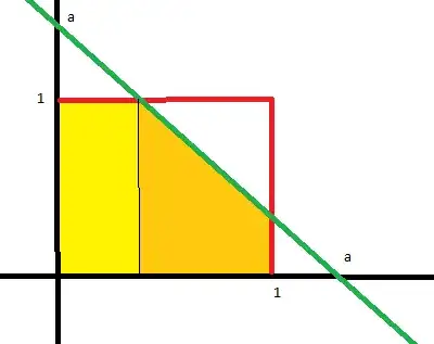

Now at this point I am confused where to put the green line. Does it make a difference if it is before $1$ or after $1$? If I put it after the $1$ would I have to calculate two different regions like this:
whereas if it is before the $1$ I only have to calculate one region? If so, how do I account for both possibilities?
Also, what do all the answers in those posts mean when they say you have to split up $a$ into two possibilities, one where $0\le a \le 1$ and one where $1\le a \le2$? Can somebody please explain to me in detail why that is necessary, what it actually means, if it can be illustrated in the diagram, and how exactly it expresses itself when setting up the integrals?

First let's just think geometrically. The behavior changes depending on whether $a<0,0<a \leq 1,1<a<2$ or $a \geq 2$:
  • $a \leq 0$: the area under the line doesn't overlap with the square at all.
  • $0<a \leq 1$: the area under the line overlaps with the square in a right triangle.
  • $1<a<2$: the area under the line overlaps with the square in a trapezoid. You can reduce this to the previous case by noting that the area above the line overlaps with the square in a triangle again.
  • $a \geq 2$: the area under the line contains the entire square.
Now returning to doing it symbolically. Your first attempt:
$$\int_0^1 \int_0^{a-y} \, dx \, dy$$
is on the right track, but it misses some things. First, when $0<a<1$, $y$ cannot go all the way up to $1$, it can only go up to $a$, so you get
$$\int_0^a \int_0^{a-y} dx dy.$$
Second, for $a>1$, your attempt is too big because it includes the white triangle at the top left of the figure. You can fix that by clamping the integral to the top of the square, as
$$\int_0^1 \int_0^{\min \{ 1,a-y \}} \, dx \, dy.$$
If you don't like how these two cases look different, you can force them to look the same by writing it as
$$\int_0^1 \int_0^{\max \{ 0,\min \{ 1,a-y \} \}} \,dx\, dy.$$
