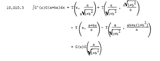

Owen's Table of Normal Integrals provides the indefinite integral
Indefinite Integral
Just insert your integration limits, replace the normalized Laplacians by the erf with a few steps and you are done. But the answer is not very useful as it involves 4 times Owen's T function...

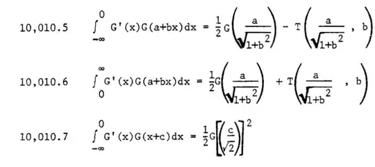

For $c=1$ and $d=0$, Owen's Table of Normal Integrals gives you a simplified answer but only for a few limits
SpecialCase
where the middle on appears to be yours. Personally, I am still trying to get a derivation of these integrals which turns out to be really hard, see here.
