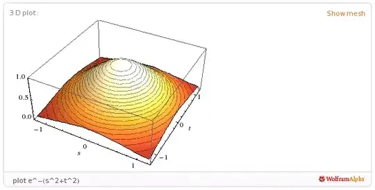

The interesting part is $\pi$. Every time it shows up you can suspect that somewhere circles are involved (and may that be deeply hidden within the structure). And indeed this is the case here!
To be precise we are talking not about $\pi$ but about $\sqrt{\pi}$ here. So the circles show up when you square the function which means that you go one dimension up. It follows that in order to see the circles we must look at the two dimensional normal curve:
surface plot

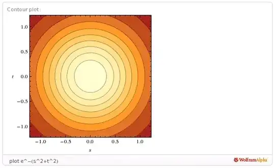

When you look at the contour lines you will see the circles!
surface and contours
This will become even clearer when you have a look at the contour plot!
contour plot
Sources:
(1) The plots were created with WolframAlpha.

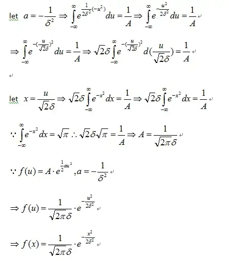

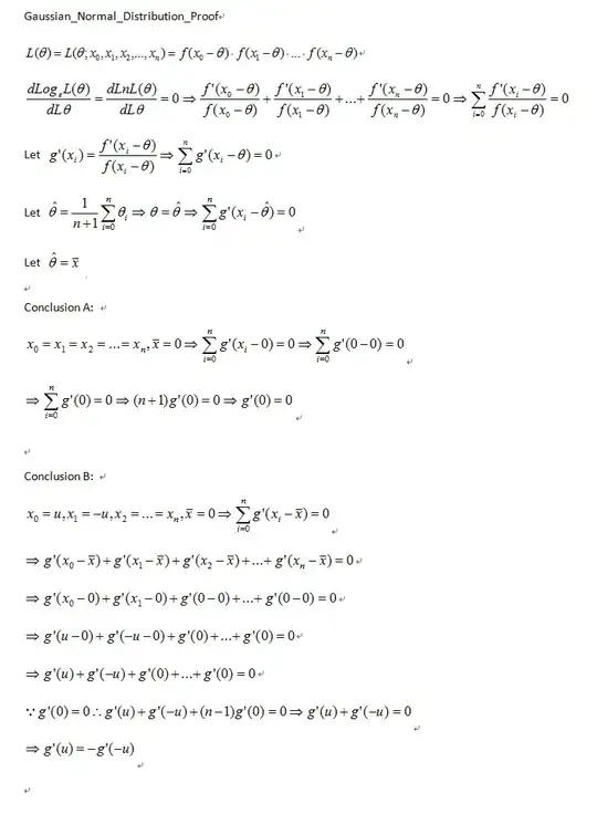

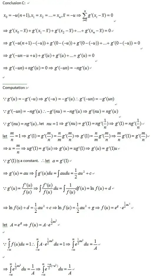

-2
Gaussian Normal Distribution Proof 01enter image description here
