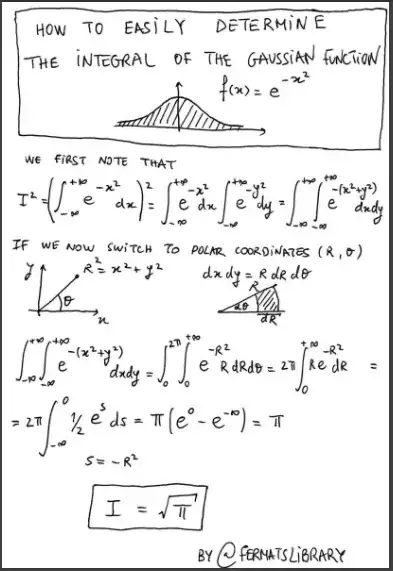

It is clear that the sooner we get to Pythagoras the smoother the path will be... Which reminds me of a recent tweet by @fermatslibrary that just starts point blank with the square of the integral:

It's true that once we get down to one dimension, the distribution loses that motivation. Also, this is probably just my ignorance talking, but I know of no other way to compute the normalization factor without the trick of first squaring the distribution.
