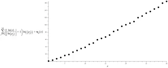

The asymptotic relation I think I originally started from, which think is actually false as I originally stated, but again, just curious about the division relation on the naturals I really am new to asymptotics:
$$\sum _{j=1}^{ \lfloor x \rfloor } \left( \Bigl\lfloor {\frac {\ln \left( x \right) }{\ln \left( p_{{j}} \right) }} \Bigr\rfloor +1 \right) \ln \left( p_{{j}} \right)+\psi_{{0}}(x) \sim x $$ enter image description here

  • I can't prove it, but it looks like $\psi_1(n)\sim \psi_0(n)\sim n$ (the second one follows from the prime number theorem but I can't prove the first yet). – Carl Schildkraut Jul 15 '18 at 22:21
  • I added a plot that I think confirms what you are saying – Adam Ledger Jul 15 '18 at 22:44
