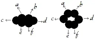

To find a good intuition I have worked with two examples of spaces which I named $A$ and $B$;
$A=[\{a,b,c,d,e,f\},(\{a,b,c,d,e,f\},\{\},\{a,b,c,e,f\},\{e,f\},\{a,b\},\{a,b,d,e,f\},\{a,b,e,f\})]$,
$B=[\{a,b,c,d,e,f\},(\{a,b,c,d,e,f\},\{\},\{a,b,c,e,f\},\{a,b,d,e,f\},\{a,b,e,f\})]$
and I obtained the next pictures (and here is my first question: are these the correct spatial representaition of the spaces? $A$ is in the right, $B$ is the left, the black circles represent points):
And then the union axiom allows to establish different degrees of nearness, specifically the opens that aren't union of other opens have near points, and the unions have points nearer than other points that aren't. Concretely in the space $A$; $\{e,f\}$ and $\{a,b\}$ are nearer than $c$ and $d$, then the unions allow to speak of a "global " nearness.
The intersection axiom also talk about different degrees of nearness, in the way that if we have near points and we have other near points that have common points, then than points are near, and in fact they are nearer, and so the intersection talk of a "local" nearness.
And finally the axiom of the necessary membership of the space itself and the empty set, guarantees the fact that "there are nothing outside the space" or the totality of the space and in that sense all the points are near in the space.
Is this a good intuition? if not, please give me a good one.
