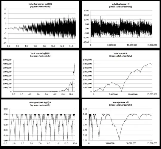

From the graphs below, we can see that the curves are clearly skewed in every set. Meaning that in any given interval (2-4, 5-13, 14-40...), the higher scores are always skewed and always appear more often at the start of the set, and the negative scores are always more prevalent towards the end of the set. We can see also how the average score never goes below zero, so the negative scores never cumulatively outnumber the positive ones either.
So there are two cases of uniform selection:
Case 1: You choose your X randomly on any set of these sets, or any interval [1, ..., N] that ends on a set boundary, or on the natural numbers > 0 in general:
The average score will be zero.
Case 2: Any other case of uniform distribution >= 1 or >= 2:
We can assume there is a hard boundary [1, ..., N], or you subconsciously limit yourself to some range [1, ..., N]. However the boundary is set, if it's more than a hundred or so, it's extremely unlikely to be on a set boundary.
But if you choose a number uniformly on a range that isn't the end point of a complete set, your range will include a number of complete sets + part of an incomplete set - and the incomplete set will have more positive than negative scores because the values within the incomplete set always excludes from the end part (more negative scores prevalent) and not from the beginning part (more positive scores prevalent).
So the overall score will average to some value > 0. This is the case whether the lower limit is 1 or 2 (or indeed 5 or any other Min(n)).
We can also see from the graphs or algebraically that the average score on any interval is between +0 and +0.5 for all uniform intervals [1, ..., N], so this sets an upper limit as well - whatever interval you choose [1, ..., N], the average will never be >= 0.5 in the long term.
Useful graphs
(The structure of the data is also reminiscent of the Blancmange curve, or one of its related curves, see pictures for w=1/2 and w=2/3 in that link.)
