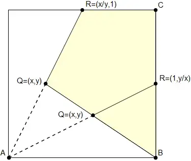

Suppose we start with $Q = (x, y)$. The admissible positions for $P$ will be in the triangle $BQR$ if $y < x$ or in the quadrilateral $BQRC$ if $y > x$. The areas are calculated from the sides and the heights, and $$p = \int_0^1 \int_0^x \frac {y (1 - x)} {2 x} dy dx + \int_0^1 \int_x^1 \left( 1 - \frac x {2 y} - \frac y 2 \right) dy dx = \frac 1 4.$$

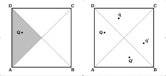

Consider the point $Q$ only in a quarter of the square $\square ABCD$, as shown in the left plot below. We will combine the "region of $P$ that creates a crossing" associated with $Q$ and its 4-fold symmetric mirror images.

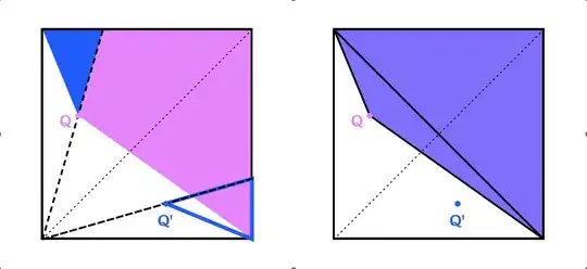

As the right plot below shows, point $Q'$ is reflected with respect to (WRT) the main diagonal $\overline{AC}$, point $q$ is reflected WRT the off-diagonal $\overline{BD}$, and point $q'$ is doubly-reflected (equivalent to rotated $180^{\circ}$). enter image description here The region that is admissible (borrowing the great term from @Maxim) associated with $Q$ is highlighted below on the left (in magenta), and the region for $Q'$ is highlighted on the right plot (in blue).

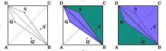

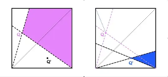

The labels for corner points $A,B,C,D$ will be omitted in the plots from now on, because they are unnecessary most of the time and a bit distracting. enter image description here We can cut-and-paste the triangular blue "$Q'$ region" in the manner demonstrated below, thanks to the mirror symmetry by construct of $Q'$.

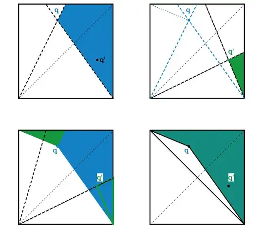

Note that the resultant quadrilateral consists of an obtuse triangle ($\triangle DQB$) plus THE isosceles right triangle, which is half of $\square ABCD$. enter image description here Similarly, the admissible regions associated with $q$ and $q'$ can be cut-and-paste into a quadrilateral that is half of $\square ABCD$ minus an obtuse triangle ($\triangle DqB$).
I sincerely apologize for the poor choice of colors if the readers find the figures unclear.
Due to the symmetry WRT the off-diagonal, we can cut-and-paste (flip) the combined-$(q,q')$-region and have the exact full square.
