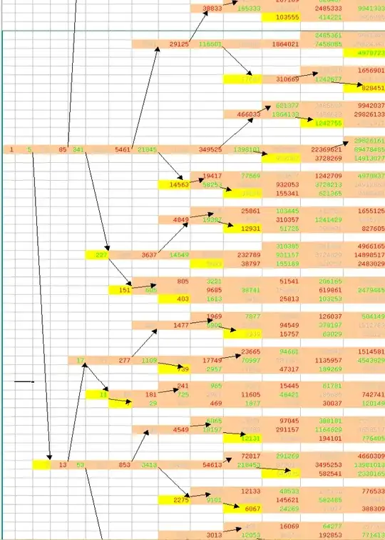

If you ask for odd numbers $a$ which reduce in one odd step to $1$ then you can solve the equation $$\begin{array} {} {3a+1 \over 2^A} &=& 1\\ 3a+1 &=& 2^A \\ 3a &=& 2^A-1\\ a &=& {2^A-1\over 3} \end{array}$$ and you get an infinite set of numbers $a_A$ depending on any $A$'s which make the last rhs an odd integer.
For the infinite set of $A \in \{2,4,6,...\}$ we get an infinite set of $a \in \{1,5,21,85,341,... \}$ .
One can now observe, that the numbers of the (infinite) subsets $\{5,341,... \}$ and $\{1,85,...\}$ which are proven to fall down to $1$ by one odd step, can be taken as endpoint of another odd step, for instance $5$ $$\begin{array} {} {3b+1 \over 2^B} &=& 5\\ 3b+1 &=& 5 \cdot 2^B \\ 3b &=& 5 \cdot 2^B-1\\ b &=& {5 \cdot 2^B-1\over 3} \end{array}$$ and of course for the set $B \in \{1,3,5,7,...\}$ we get the infinite set $b \in \{ 3,13,53,... \}$
So this is another infinite set which is proven to fall down to $1$ - in this case by two odd steps.
Of course this can be done for $85$ instead of $5$ and it is very easy to define a lot of infinite sets of numbers which fall down to $1$ by one odd step, by two odd steps, by three odd steps and so on.
All these sets are infinite and thus do not have some "largest" element which must be determined empirically ...
For more illustration of this you might be interested in my small collection of textual and grafical trees at my early collatz-pages with the subpage on "grafical and textual trees".
See a screenshot of the "numerical tree" page. All rows in this Excel-generated sheet show the heads of infinite sequences of simple classes of numbers with geometric progression $a_{k+1}=4a_k + 1$ . For all those infinite sequences the Collatz-conjecture is immediately proven - the Collatz-transformation (in its Syracuse-formulation) goes in reverse direction of the arrows, for instance $3 \to 5$ and then inside the row which contains the $5$ left towards its head, which is $1$ and which is thus the root of the whole doubly infinite tree.
