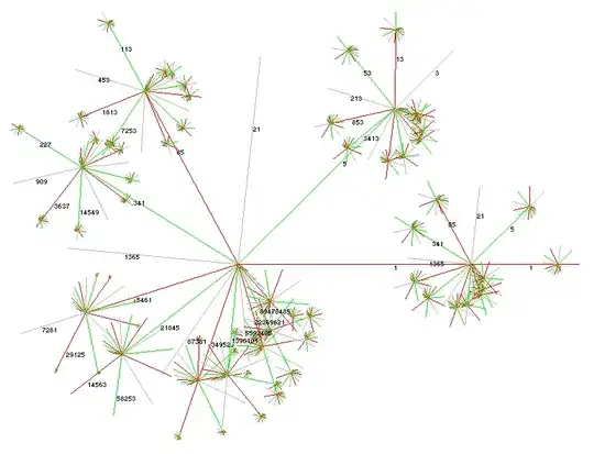

You might like to see some examples of various forms of trees (of course which are recursive) to see a lot more subsets of odd numbers being proved to converge by these schemes. Obviously they are infinitely many such infinite subsets. But unfortunately that does not mean, that it would have been proven that all odd positive natural numbers are in that single tree.
See mainpage and then go to subpage "about numerical and graphical trees". My favourite is that "bottle-brush" like tree at the end ... bottle-brush

    @BinhHo - of course! It might be instructive to denote that numbers in base-4-numbersystem: '1' , '11' , '111', ... Then, that of the subset $3,13,53,...$ are '3', '31' , '331', '3331' , ... Then that of the subset $17,69,...$ are '101', '1011', '10111', ... . And so on... – Gottfried Helms Aug 23 '19 at 12:49
  • upps - correction: in my previous comment should it be '3','31','311','3111',... of course. – Gottfried Helms Aug 23 '19 at 14:54
  • interesting! Do you think that from this fact we can prove all positive odd numbers? I know that the binary number system can represent all positive integers, and maybe we can deduce the 4 number system down to binary. – Binh Ho Aug 23 '19 at 15:19
  • @BinhHo - no, that is not easier than anything else. Note that the same scheme exists for the negative numbers and there we have three independent, nonoverlapping trees. Only the visualization is much more impressive than the usual one. – Gottfried Helms Aug 23 '19 at 15:42
