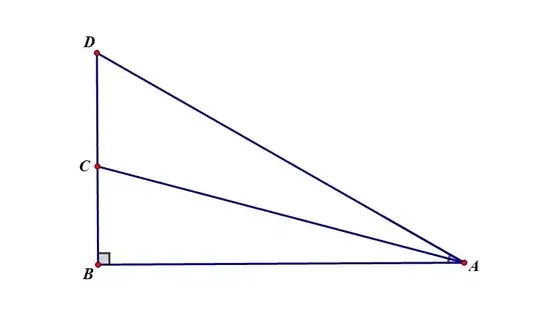

Yes, a $15-75-90$ triangle may be the one you want.
Assume we have a right $\Delta ABC$ with $\widehat{BAC}=15^0;\widehat{ABC}=90^0;\widehat{ACB}=75^0$.
Put an extra point $D$ like above so that $B,C,D$ are collinear and $AC$ is the angle bisector of $\widehat{DAB}$, this means $\widehat{DAB}=30^0;\widehat{BDA}=60^0$.
Let $DB=a$. Then the special right triangle $\Delta ABD$ will have $AD=2a$ and $AB=\sqrt{3}a$.
Because $AC$ is the angle bisector of $\widehat{DAB}$, we have $\frac{CB}{CD}=\frac{AB}{AD}=\frac{\sqrt{3}}{2}$.
We have this set of equations: ${\begin{cases}DB=CB+CD=a\\\frac{CB}{CD}=\frac{\sqrt{3}}{2}\end{cases}} \Rightarrow {\begin{cases}CD=\left(4-2\sqrt{3}\right)a\\CB=\left(-3+2\sqrt{3}\right)a\end{cases}}$
Apply the Pythagorean theorem: $CA=\sqrt{AB^2+BC^2}=\sqrt{(\sqrt{3a})^2+((-3+2\sqrt{3})a)^2}=\sqrt{(24-12\sqrt{3})a^2}=\sqrt{24-12\sqrt{3}}a$
We conclude that $sin(15)=sin\widehat{BAC}=\frac{BC}{CA}=\frac{-3+2\sqrt{3}}{\sqrt{{24-12\sqrt{3}}}}=\frac{-3+2\sqrt{3}}{3\sqrt{2}-\sqrt{6}}=\frac{\sqrt{6}-\sqrt{2}}{4}$.

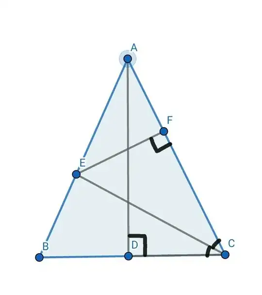

A $72^{\circ}-36^{\circ}-72^{\circ}$ isosceles triangle gives $$\sin 18^{\circ}=\frac{\sqrt 5-1}{4}$$ enter image description here $\Delta ABC$ is an isosceles triangle. $AB=AC=a, \angle A=32^{\circ}, AD\bot BC, CE$ is bisector of $\angle C$ and $EF\bot AC$. We observe that $BC=EC=EA=x$. Now, $\Delta ABC\sim CEB.$ Hence,
$$\frac{AB}{CE}=\frac{BC}{EB}\\ \frac ax=\frac{x}{a-x}\implies x^2+ax-a^2=0\\ \frac xa=\frac{\sqrt 5-1}{2}\\ \sin \angle BAD=\frac{BD}{AB}\\ \sin 18^{\circ}=\frac{\frac x2}{a}=\frac{\sqrt 5-1}{4}$$ Similarly $\cos 36^{\circ}$ can be found from this triangle.
dssknj
