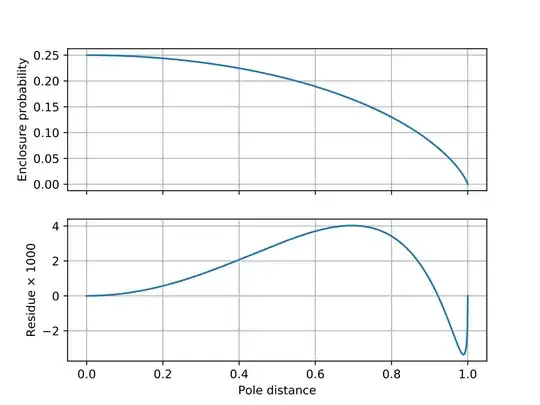

I did give an approximation to $P(x)$ and showed that it had an error of no more than around 0.004 via matplotlib. (In the graphs below, the pole refers to the fixed point.) $$P(x)\approx\frac{(1-x^2)^{2/3}}4$$
But the relative size of the error irritated me – I had tried more complicated approximations, with only marginal improvements. Then I got the idea of using Taylor series for a better approximation – $P(x)$ is only defined on $[0,1]$, within the radius of convergence for many Taylor series.

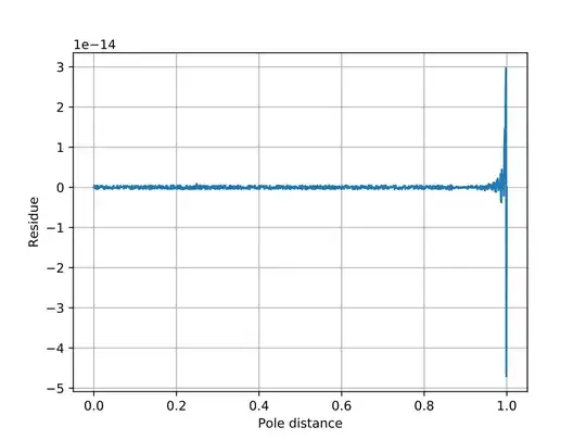

Therefore I could write $$P(x)=\frac14-\frac3{\pi^2}\sum_{n=1}^\infty\frac{x^{2n}}{2n^2}$$ Thus was revealed the series expansion of the dilogarithm, the simplest expression for $P(x)$ and perhaps the most elegant equation I have encountered: $$\bbox[5px,border:1px solid black]{P(x)=\frac14-\frac3{2\pi^2}\operatorname{Li}_2(x^2)}$$ I confirmed the correctness of this expression by comparing its values to my precomputed samples of $P(x)$, finding nothing but round-off error in the latter:

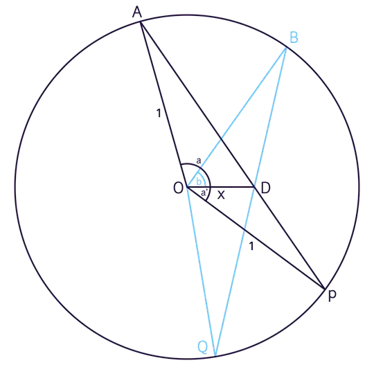

The logarithmic form $(1)$ of the integrand in $P(x)$ may help. Besides Taylor series, I am open to proofs that exploit the geometry of the situation; here is the diagram I used to justify the integral expression for $P(x)$.
Here $O$ is the origin and the arguments of $A$ and $B$ when treated as complex numbers are $a$ and $b$, lying in $[0,\pi]$ and $[0,a]$ respectively. The argument of the triangle's third point (not shown) lies in $[-\pi,0]$ and has to be between $P$ and $Q$ for the triangle to contain the fixed point $D$ at $(x,0)$. The first term in the integrand $\sin^{-1}\frac{x\sin b}{\sqrt{1+x^2-2x\cos b}}$ is $\angle DOQ$, the second term $\angle DOP$.
