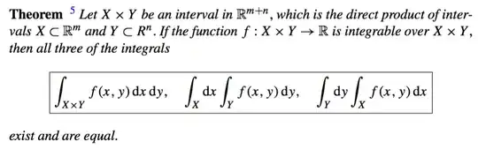

Reference:(Fubini's Theorem)
Question:
Is there any example for $f: I\to \mathbb{R}^n$ both the iterated integrals in Fubini's theorem exists and are equal, yet $f \not \in R(I)$ ?

Answer to the question below. First we should note that the theorem as stated is false, if we're talking about Riemann integrals.
Let $X=Y=[0,1]$. Let $f(x,y)=0$ if $y\ne0$; let $f(x,0)=1$ if $x$ is rational, $0$ otherwise. It's easy to see from the definition that $f$ is Riemann integrable on $X\times Y$ (or note that $f$ is certainly continuous almost everywhere.) But $\int_0^1 f(x,0)\,dx$ does not exist, hence at least one of the iterated integrals fails to exist.
Fubini's theorem would be one reason they invented the Lebesgue integral... It turns out that that little detail, a function has to be defined on $X$ before it can be Riemann integrable on $X$, is the only problem:
Theorem: Suppose $f$ is Riemann integrable on $X\times Y$ as above. If $g(x)=\int_Yf(x,y)\,dy$ exists for every $x\in X$ then $g$ is Riemann integrable and $\int_X g(x)\,dx=\int_{X\times Y}f(x,y)\,dxdy$.
Proof, in questionable taste: For a given $x$, if $f$ is continuous at $(x,y)$ for almost every $y$ then DCT shows that $g$ is continuous at $x$. So the measure-theory Fubini's theorem shows that $g$ is continuous almost everywhere, hence Riemann integrable. The measure-theory Fubini theorem shows that $\int_X g(x)\,dx=\int_{X\times Y}f(x,y)\,dxdy$.

The statement of the Theorem given as a reference is false. As such, it is just a distraction with respect to the Question, which David C. Ullrich has answered by providing a nice example.
I just will focus on the theorem to help clarify beyond what has already been discussed in the comments.
The hypothesis is that the bounded function $f:X \times Y \to \mathbb{R}$ is Riemann integrable on the bounded interval (rectangle) $X \times Y \subset \mathbb{R}^{n+m}.$ What is a true statement is that
$$\tag{1}\int_{X \times Y} f = \int_X \left(\underline{\int}_Y f(x,y) \, dy\right) dx = \int_X \underline{J}(x) \, dx \\ = \int_X \left(\overline{\int}_Y f(x,y) \, dy\right) \, dx = \int_X \overline{J}(x)\, dx, $$
where for fixed $x\in X$ the lower and upper Darboux integrals appearing above must exist (since $f$ is bounded) and as a conclusion are themselves Riemann integrable over $X$ and satisfy (1).

Correction of the Theorem (Zorich)
Since $\int_X \overline{J}(x) \, dx = \int_X \underline{J}(x) \, dx $ and $\overline{J}(x) \geqslant \underline{J}(x)$, it follows that $\overline{J}(x) = \underline{J}(x)$ almost everywhere, and the Riemann integral
$$\int_Y f(x,y) \, dy$$
exists except perhaps for $x$ in a set of measure zero where $\underline{J}(x) < \overline{J}(x)$ with strict inequality.
As pointed out by David C. Ulrich, that does not mean that a value may be assigned arbitrarily to the "symbol" $\int_Y f(x,y) \, dy$ and the Theorem holds. What Zorich should have stated is let the function $F:X \to \mathbb{R}$ be defined as
$$F(x) = \int_Y f(x,y) \, dy$$
when that integral exists, and let it be defined as any value in the interval $[\underline{J}(x), \overline{J}(x)]$ when $\underline{J}(x) < \overline{J}(x)$ and the integral does not exist. Then instead of (1) the correct statement is
$$\tag{2} \int_{X \times Y} f = \int_X F(x) \, dx,$$
with something similar when the order of integration is reversed.
