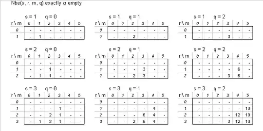

For the very few lowest values of the parameters the attached are the values that we get applying the formula for $N_{be}$ given above.
You can verify that they are correct.

  • @Eyalbc: hi Eyal, my name is Giuliano. Of course your numbers do not align: for $q=0$, $N_{be}$ can't be equal to $N_b$. $N_{be}$ is the number of ways to have exactly, repeat exactly , $q$ bins empty, and not at least $q$. To get the last you have to sum $N_{be}(q)+N_{be}(q+1)+\cdots$. I added some computed values for you to check with your computations. – G Cab Mar 31 '18 at 10:42
