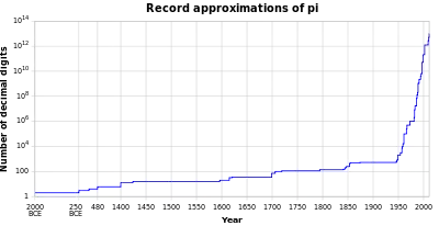

I have always wondered how the digits of π are calculated. How do they do it?
Pi records

The Chudnovsky algorithm, which just uses the very rapidly converging series $$\frac{1}{\pi} = 12 \sum^\infty_{k=0} \frac{(-1)^k (6k)! (13591409 + 545140134k)}{(3k)!(k!)^3 640320^{3k + 3/2}},$$ was used by the Chudnovsky brothers, who are some of the points on your graph.
It is also the algorithm used by at least one arbitrary precision numerical library, mpmath, to compute arbitrarily many digits of $\pi$. Here is the relevant part of the mpmath source code discussing why this series is used, and giving a bit more detail on how it is implemented (and if you want, you can look right below that to see exactly how it is implemented). It actually uses a method called binary splitting to evaluate the series faster.
