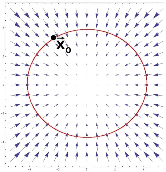

Let's say $\boldsymbol{\vec F}$ is a field vector with a liner relationship
$$\boldsymbol{\vec F}(\boldsymbol{\vec x})=\boldsymbol A \boldsymbol{\vec x}$$
where $\boldsymbol{\vec x}$ is a vector of size $n$ and $\boldsymbol A$ is a constant $n\times n$ square matrix.
For a given point $\boldsymbol{\vec x}_0$, how can I find the hyper-surface $S(\boldsymbol{\vec x})=0$ which crosses $\boldsymbol{\vec x}_0$ and it is perpendicular to the vector field $\boldsymbol{\vec F}$?
I believe this there is an explicit form of the surface which depends on $\boldsymbol{\vec x}_0$ and $\boldsymbol A$.
On hyper-surface $S$, there will be $n-1$ degree of freedom.
I am looking for a solution for an $n$ dimension vector field. This image is just for illustration.

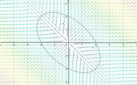

Example
Let $n=2$. Given $\mathrm A = \begin{bmatrix} 2 & 1\\ 1 & 2\end{bmatrix}$ and $\mathrm x_0 = \begin{bmatrix} 2\\ 0\end{bmatrix}$, we obtain the function
$$f (x_1, x_2) = x_1^2 + x_1 x_2 + x_2^2 - 4$$
The following plot depicts the level set (an ellipse) and the vector field. The length of the arrows is not proportional to $\| \rm A x \|_2$. The purpose is to show that the vector field is orthogonal to the ellipse.
ellipse and vector field
