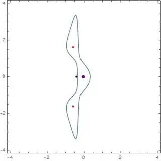

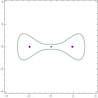

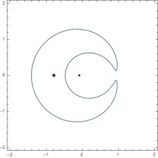

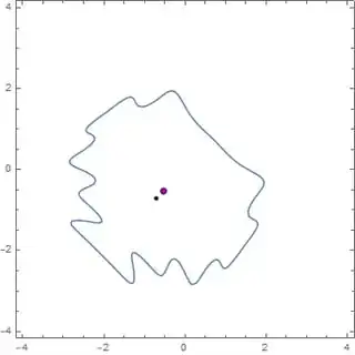

I plotted $\mathbf{p}$, the maximas and the curve. The red dots reprsent the maximas, the blue dot repesents $\mathbf{p}$ and the black dot represents the centroid.
Show[ContourPlot[S1[x, y] == 1, {x, -4, 4}, {y, -4, 4}],
 Graphics[{PointSize {Medium}, Blue,
   Point[{x /. s[[2, 1]],  y /. s[[2, 2]]}]}],
 Graphics[{PointSize {Medium}, Black, Point[{J[[1]], J[[2]]}]}]]
Here are some examples. I'm unable to solve my center in closed form.
$2x^2+2y^2+7y\sin{(xy)} + 7x\sin{(x)}=1$
Center1
$x^2 + x + y^2 + y + \sin(xy) + \sin(3xy)=4$
Center2
$(x^2+y^2-1)^2+.415x=.4$
Center3
$81y^2-x^4\left(9-x^2\right)=4$
Centers4
Pros and Cons of "The Center Property"
Pros:
  • Its reasonable
  • Close to the centroid if star-shaped
  • Within the boundary of the curve (if star-shaped)
  • Leads to interesting problems regarding the maxima of $\overline{r}(x,y)$
Cons:
  • Tedious to solve mathematically. Rarely has a closed form. Rarely has an elegant solution.
  • If curve is 2-d, even if $\overline{r}$ is exact, you must find the maxima of $\overline{r}(x,y)$ in 3-d Coordinates
  • If the curve is 3-d, you must find the maxima of $\overline{r}(x,y,z)$ in 4-d Coordinates.
Unproven Assumptions
  1. If the curve is star-shaped and closed $\overline{r}$ has one maxima
  2. If the curve is star-shaped and closed, $\mathbf{p}$ stays inside.
  3. If the curve is star-shaped and closed one $\mathbf{p}$ exists
  4. The proximity of the centroid and "the property" determines the even distribution of the closed shape.

This fact makes it easy to construct a counterexample to assumption 1: Consider a dumbbell-shaped curve, enclosing two unit disks centered at $(-2,0)$ and $(2,0)$ connected by a thin path. One can verify numerically that there are two maxima, located in the interior of the two disks. It should also be possible to construct a counterexample to assumption 2 by considering a single disk with a long thin notch cut out of it, so that the center is inside the notch and thus outside the curve.
