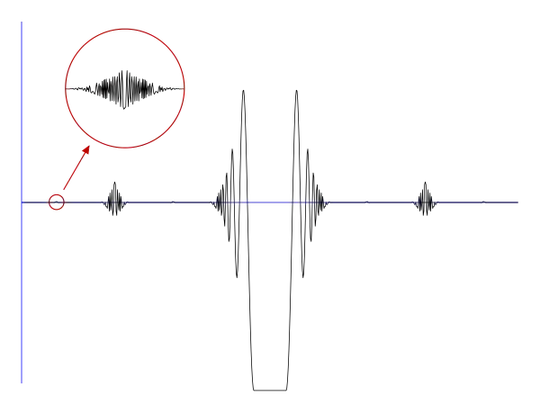

From the two examples provided above, it turns out that the desired function $f$ is chosen in such a way that $f'$ is unbounded. However, turning a function $f$ into unbounded $f'$ is somewhat not interesting. If you really want to look for an example of $f$ such that $f'$ is defined and bounded everywhere, the Volterra function is what you are looking for. This function is defined by making use of the Smith–Volterra–Cantor set and "copies" of the function defined by $$\left\{ \begin{aligned} & x^2 \sin ⁡ \frac 1x & & \text{for } x\neq 0 \\ & 0 & & \text{for } x=0. \end{aligned} \right.$$ The first three steps in the construction of Volterra's function are as in the picture below.
