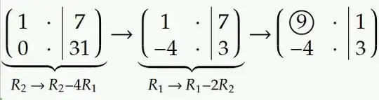

$$7x\equiv 1\pmod{31}$$
We are seeking integer solutions of the equation,
$$7x+31y=1$$
Find a linear transformation $\begin{pmatrix}\cdot & \cdot \\ \cdot &\cdot\end{pmatrix}$ consisting of integer entries which maps the vector $\begin{pmatrix}7\\ 31\end{pmatrix}$ to some vector of the form $\begin{pmatrix}1\\ \cdot\end{pmatrix}$ or $\begin{pmatrix}\cdot\\ 1\end{pmatrix}$.
The identity transformation: $$\begin{pmatrix} 1 & 0\\ 0 & 1\end{pmatrix}\begin{pmatrix} 7\\ 31\end{pmatrix} =\begin{pmatrix}7\\31\end{pmatrix}$$
Now apply successive elementary row operations on the augmented matrix until you get the desired form on the RHS.
$$\Longrightarrow \begin{pmatrix} 9 & -2\\ -4 & 1 \end{pmatrix}\begin{pmatrix} 7\\ 31 \end{pmatrix} =\begin{pmatrix} 1\\ 3 \end{pmatrix}$$
$$\Longrightarrow 7( 9) +31( -2) =1\\ \Longrightarrow x\equiv 9\pmod{31}$$
This is just a different perspective to the extended Euclidean algorithm. I think this is useful, if you want to code the algorithm :)
Ideally, if you are up for finding $x$, you would not calculate the values on the second column because those are of no use.
