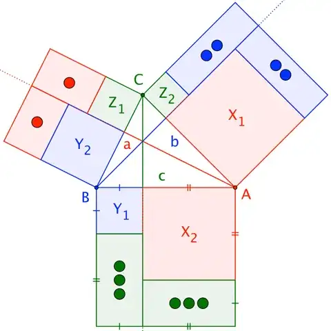

Taking a cue from my Law of Cosines trigonograph, we have a straightforward arithmetic of areas:
$$\begin{align} \\ \\ \\ \color{red}{X_1} + \color{blue}{[\bullet\bullet\phantom{\bullet}]} &\quad=\quad \color{red}{X_2} + \color{green}{[\bullet\bullet\bullet]} &=\quad b c \cos A \\ \color{blue}{Y_1}\, + \color{green}{[\bullet\bullet\bullet]} &\quad=\quad \color{blue}{Y_2}\, + \color{red}{[\bullet\phantom{\bullet}\;\;\phantom{\bullet}]} &=\quad c a \cos B \\ \color{green}{Z_1} + \color{red}{[\bullet\phantom{\bullet}\;\;\phantom{\bullet}]} &\quad=\quad \color{green}{Z_2} + \color{blue}{[\bullet\bullet\phantom{\bullet}]} &=\quad a b \cos C \\ \hline \\ \color{red}{X_1} + \color{blue}{Y_1} + \color{green}{Z_1} &\quad=\quad \color{red}{X_2} + \color{blue}{Y_2} + \color{green}{Z_2} \end{align}$$
Blue
  • 75,673
    How long does it take you to make these beautiful geometry diagrams ? – Caleb Stanford Oct 24 '17 at 17:55
    @6005: Thanks for the compliment! :) Deciding what I actually want to draw usually takes the most time. In this case, that part went rather quickly because I had just been thinking about the Law of Cosines diagram in the past few days, and it was "obvious" that Steiner's result might follow fairly directly. In any case, once I have an idea, coaxing a diagram I like out of GeoGebra ---and then making tweaks in Photoshop--- isn't terribly difficult or time-consuming. I believe I posted my first pass at the answer above (which showed the diagram alone) within an hour of seeing the question – Blue Oct 24 '17 at 22:32

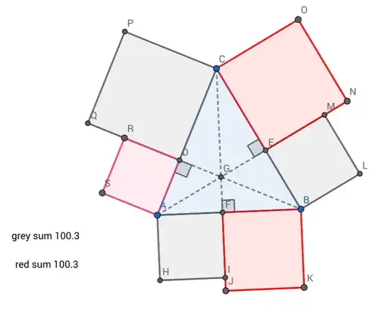

I am not sure it's all that complicated.
Note that by the Pythagoras theorem, all the following are true:
$CE^2 = AC^2 - AE^2$
$FB^2 = CB^2 - CF^2$
$AD^2 = AB^2 - BD^2$
$EB^2 = AB^2 - AE^2$
$FA^2 = AC^2 - CF^2$
$DC^2 = BC^2 - BD^2$
From the above, it is easy to see that: $$ CE^2 + FB^2 + AD^2 = EB^2 + FA^2 + DC^2 \\= (AB^2 + AC^2 + BC^2) - (AE^2 + CF^2 + BD^2) $$
Since nobody mentions the point $G$, here is another proof (although for this you have to use that the altitudes of a triangle always meet):
Consider the six small triangles involving $G$ (that is $AGF$, $GBF$ and so on) and invoke the Pythagorean theorem for each of them. Then for the grey squares we get
$$AF^2 + BE^2+ CD^2 = (AG^2 - FG^2) + (BG^2- EG^2) + (CG^2 - DG^2) $$
and for the red squares
$$ AD^2 + CE^2 + BF^2 = (AG^2 - DG^2) + (CG^2 - EG^2) + (BG^2-FG^2)$$ which are the same 6 terms, so both sums are equal.

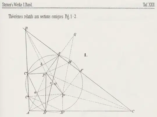

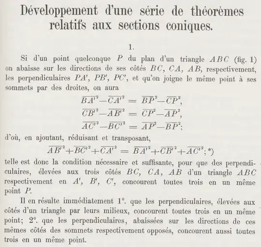

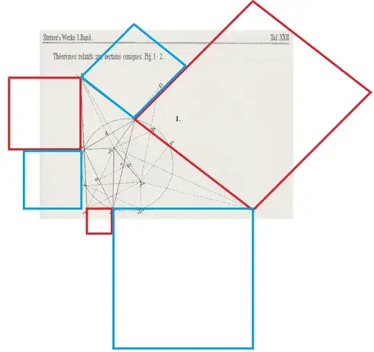

(Community wiki.) As pertains to the claim that this was proved by Steiner, Viktor Blåsjö‏ points to Steiner's Werke, volume I, page 189 in a tweet accompanied by the following two images:
For completeness, here is the figure with the corresponding identity in $*$ illustrated geometrically:
where the summed area for the red and blue squares, respectively, are equal.
The above generalization, where the squares aren't determined specifically by altitudes (ie, by perpendiculars from the orthocenter) but rather by perpendiculars from an arbitrary point $P$, is known as Carnot's Theorem, not to be confused with Carnot's Theorem. Could this be one of those cases where the "wrong" name has been attached to a result? (Note that Steiner (1796–1863) and Carnot (1753–1823) were contemporaries.)
