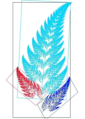

Iterated Function Systems are fun to draw and are computed with matrices. They can also illustrate what matrix multiplication does.
As an example, this draws Barnsley's fern:
import numpy as np
from random import randint
fig = plt.figure()
mats = [np.array([[0.8,0.03],[-0.03,0.8]])]
mats.append(np.array([[0,0.3],[0.3,0]]))
mats.append(np.array([[0,-0.3],[0.3,0]]))
mats.append(np.array([[0,-0.006],[0,0.2]]))
offsets = np.array([[0,1],[0.4,0.2],[-0.4,0.2],[0,-1]])
vec = np.array([0,0])
xlist, ylist  = [], []
for count in range(100000):
    r = randint(0,100)
    i = 0
    if r > 70: i += 1
    if r > 80: i += 1
    if r > 90: i += 1
    vec = mats[i].dot(vec) + offsets[i]
    xlist.append(vec[0])
    ylist.append(vec[1])
plt.plot(xlist, ylist, color='w', marker='o', markeredgewidth=0.1, markersize=0.3, markeredgecolor='k')
plt.show()
    Since it should be programmed in Python, that is very easy: 1) import matplotlib.pyplot as plt. 2) Create a figure with fig=plt.figure() and 3) plot(x,y, color='w', marker='o') the vector $v=(x,y)^\top$ in each iteration of the loop that does the matrix multiplication. Or, more efficient, store them in e.g. a list and plot afterwards. – P. Siehr Aug 28 '17 at 15:01
  • @P.Siehr : I've given that a go, and it is indeed very easy, but ideally it should plot 100,000 points or more and doing that is very slow. It probably needs to be drawn on a bitmap. Any other ideas? – James Hollis Aug 28 '17 at 18:28
  • Then gnuplot might be more efficient. Can you do me a favor and edit your answer to include the algorithm and matrices you used? I will try it in Python tomorrow during break. – P. Siehr Aug 28 '17 at 20:09
    Your code took ~6.7sec on my machine. Using two lists vec_x and vec_y, filling it with vec_x/y.append(vec[0/1]) inside the loop and then using plt.plot(vec_x,vec_y, color='w', marker='o', markeredgewidth=0.3, markersize=1, markeredgecolor='k'), reduced the time to 0.1sec. Of course this needs more RAM (~160kB for 5000 points). Most likely this will be even faster using data structures that can preallocate memory, instead of appending lists. – P. Siehr Aug 29 '17 at 09:49
  • @P.Siehr : That's brilliant, thanks. I think there is some O(n^2) behavior if you just add dots one by one but that does not seem to be the case with lists. – James Hollis Aug 29 '17 at 12:21
