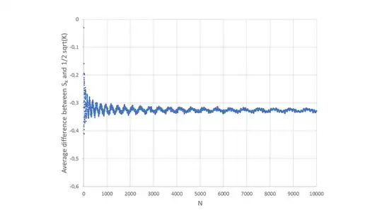

for $N \rightarrow \infty \,\,$. I am interested in this $O(1)$ term, which seems to be different from zero. Accordingly, studying the behaviour of the difference $S_K -1/2 \, \sqrt{K}\,\,\,$ over all integer values of $K$, its distribution is slightly shifted with respect to zero, and the average value seems to be $\approx -0.32... \,\,$. I tried several approaches to determine this constant term, mostly based on the Euler-Maclaurin formula, but without success. I wonder what this term is, and how it comes into this distribution.
EDIT: These are two graphs to better illustrate the question. The first one is a plot of the difference between $S_K$ and $1/2 \, \sqrt{K}\,$ vs $K$, for the first $10^4$ values of $K$. The black line is the best fitting one and is set at a value of $\approx -0.32$.
The second graph is a plot of the average value of $S_K - 1/2 \, \sqrt{K}\,$, calculated over the first $N$ positive integers, vs $N$. As expected according to the first graph, the average value of the difference converges towards $\approx -0.32$. enter image description here

    With some handwaving, it seems the limit is $-\frac14\log(2+\sqrt{3}) \approx -0.3292394742312041$ – achille hui Aug 27 '17 at 04:47

$$F(p) = \frac12 p + A(t)\sqrt{p} + B(t) + \frac{1}{24} p^{-1/2} + \cdots\quad\text{where}\quad \begin{cases} A(t) = -(\frac13 + t - t^2)\\ B(t) = \zeta\left(-\frac12\right) + \frac56 t + \frac12 t - \frac13 t^3 \end{cases} $$ Since $\displaystyle\;\int_0^1 A(t) dt = -\frac12 \ne 0$, even after we subtract away the piece $-\frac12 p$, the sum
$$\sum_{k=1}^p \left( \{ \sqrt{k} \} - \frac12 \right) = F(p) - \frac12 p$$
is still systematically biased by a term of the form $-\frac12 \sqrt{p}$. This is the source of the $O(1)$ term you notice. To see this, let us rewrite the sum at hand in terms of $F(p)$.

$$\begin{align}\frac1N\sum_{K=1}^N \left( S_K- \frac{1}{2} \sqrt{K} \right) = \frac{\mathcal{I}}{N} + O (N^{-1/2}) &\approx -\frac{1}{2N} \left[ \int_0^{2\sqrt{N}} \frac{\sqrt{3}}{2} n dn - \int_{\sqrt{N}}^{2\sqrt{N}}\sqrt{n^2-N} dn\right]\\ &= -\frac{1}{2} \left[ \frac{\sqrt{3}}{2} \int_0^{2} s ds - \int_1^2 \sqrt{s^2 - 1}ds \right]\\ &= -\frac14\log(2+\sqrt{3}) \approx -0.3292394742312041 \end{align} $$ A number compatible with what OP described in question.
