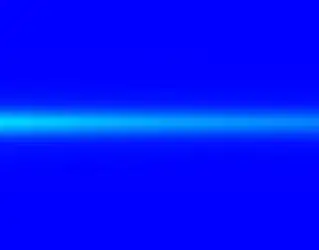

Problem is the computer code choosing one of infinite possible eigenvectors for degenerate eigenvalues in each iteration as $\omega$ changes so the final $\tau-\omega$ plot has noises.
First image is what the result is supposed to look like and the second one indicates the problem. These are not high-res outputs but I think they do the job.
