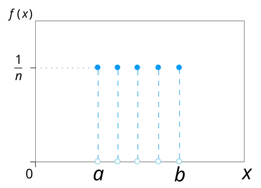

There are some distributions that are not bell-shaped at all. For example, the outcome of a roll of one fair die is a discrete uniform distribution:
Discrete uniform probability mass function for n = 5
By IkamusumeFan - Own work This drawing was created with LibreOffice Draw, CC BY-SA 3.0, Link

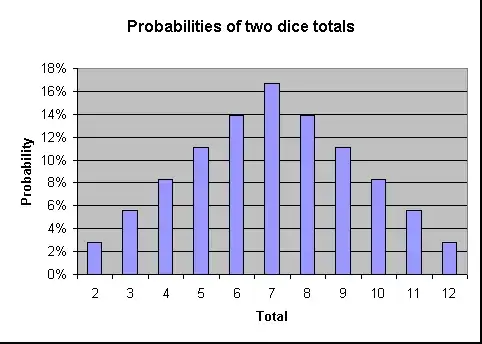

The roll of one die is a pretty simple process. What about the sum of two dice? The Wizard of Odds illustrates:

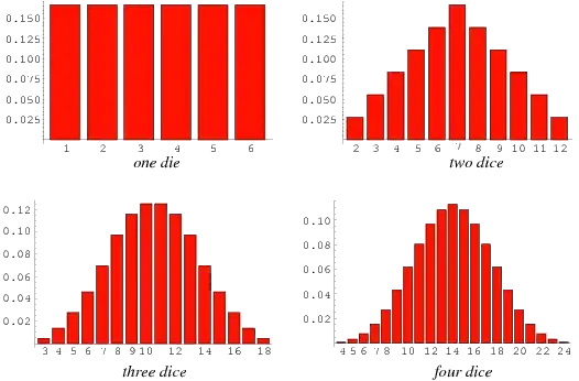

Starting to look a little like a bell, right? What about the totals of three, or four dice? Wolfram MathWorld provides a nice illustration:
You can see where this is headed. Nature is full of complex processes. How tall are you? Well, it depends on genetics, nutrition, exercise, injuries, bone loss, and so many more things. The central limit theorem shows (see symplectomorphic's comment below) that when adding the sum of a large number of things together, the resulting distribution is not just any bell-looking curve, but specifically the normal distribution. Or for things with multiplicative combination, the log-normal distribution.
