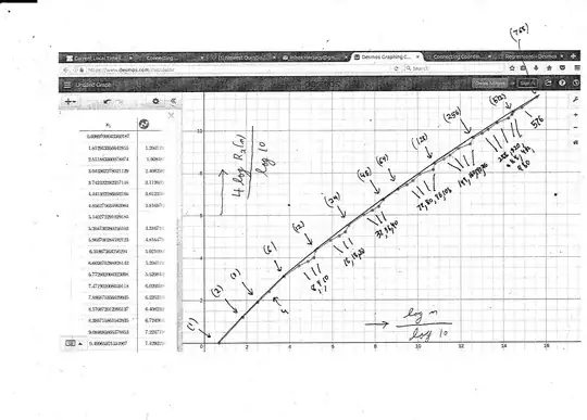

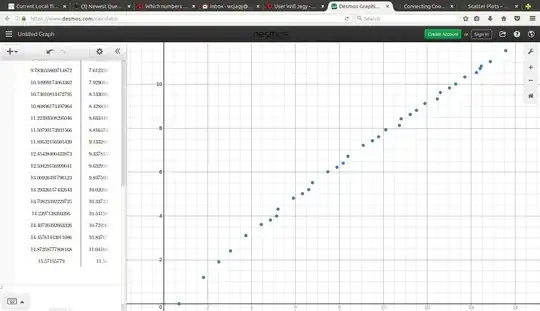

As in the srvey article by Nicolas, in a log-log graph of $\log n$ and $\log r_2(n),$ these "superior" values, in output below, show up as the vertices of the convex hull of the (infinite) graph. Note that I told it to multiply the vertical component by 4, to create a little vertical separation between nearby points. I will need to experiment to draw in the line segments, I may need to do that by hand. You can see, though, how some points in the plot below are higher compared with those nearby... Alright, added line segments and labels by hand
enter image description here enter image description here enter image description here

Will Jagy
  • 139,541
  • OK, but this doesn't get all the record setting numbers, e.g., it doesn't get that number 3159797225 with its 72 representations. – Gerry Myerson Jul 08 '17 at 08:49
    @Gerry, no, it doesn't, only certain extremal points. I learned of this first in http://math.univ-lyon1.fr/~nicolas/hcnrevisited.pdf I think I have a better scan, if so I will email you that. I like the log-log graph on page 228, it shows how the s.h.c. numbers are the vertices of a certain convex hull. – Will Jagy Jul 08 '17 at 18:32
  • But you don't show which two squares each number is the sum of. Where can I see that? Still pretty cool though. – CommaToast Jul 09 '17 at 00:56
  • @CommaToast some sort of misunderstanding. The number 341582749698577362698409832548265825625 can be written as the sum of two squares in 1474560 different ways, that is one million, four hundred seventy four thousand, five hundred sixty different integer pairs $(x,y)$ such that $0 < x < y$ and the number is $x^2 + y^2.$ – Will Jagy Jul 09 '17 at 01:09
