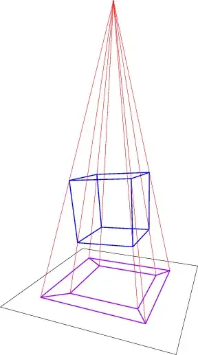

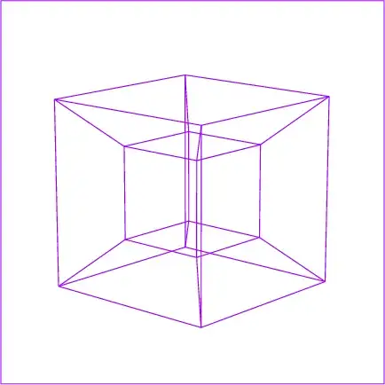

The animations below accompany an introductory talk on high-dimensional geometry.
Mathematically, the second was made by putting a "light source" at a point $(0, 0, 0, h)$ (with $h > 0$) and sending each point $(x, y, z, w)$ (with $w < h$) to $\frac{h}{h - w}(x, y, z)$.
Shadow of a rotating cube Shadow of a rotating hypercube
    This is neat. Note that the manner by which two opposing planes on the second diagram go from being nearly "adjacent" to occupying opposite sides of the tesseract entirely. This gives you an idea of the difficulty in attempting to "visualize" the tesseract. Those two planes are very close when viewed in three dimensions from one angle, yet far apart when viewed from another. – Trixie Wolf May 18 '17 at 10:40
    I like how the first image not only contains a 2D projection of a rotating 3D cube, but in addition a 2D projection of the 3D embedding of a different 2D projection of the same 3D cube. – celtschk May 19 '17 at 13:29
    Is this talk (or materials therefrom) available on the Internet? I have a few places I'd love to use such nice tools when I work with visual artists. – Prune May 19 '17 at 17:17
    @Prune: The talk is still under construction; by coincidence, these animation loops were the first materials I prepared. – Andrew D. Hwang May 19 '17 at 19:23
    @celtschk: I'd expected the "shadow of the shadow" to look flatter than it does, as with the torus shadow here. Presumably (the $1$-skeleton of) a cube is simple enough that our brains reconstruct the $3$-dimensional object even if "the shadow itself is projected". – Andrew D. Hwang May 19 '17 at 19:28
  • @AndrewD.Hwang: I think the difference is that for that torus image, the ellipses in the projection could never happen in exactly that way if it were the image of an actual torus producing the same outline. For example, consider the circles of the original torus that are mapped to lines in the torus image. If looking at an actual torus in the position of that image, you'd see ellipses in the projection, not lines. The analogue doesn't happen with your cube projection. One change that might work is to give the wires of the wireframe an actual thickness and correctly project that. – celtschk May 20 '17 at 07:13

We use the same analogies for projecting 4D-objects into 3D space (and then further into 2D-space to make an image file out of it). Look at your favorite "picture" of a 4D-cube. You recognize that it is composed of several cubes. For example, you see a small cube inside, and a large cube outside. Actually a tesseract (technical term for 4D-cube) is composed of eight identical cubes. But good luck finding these cubes in this picture. They look as much as a cube as a square looks like a square in the 2D-depiction of a 3D-cube.
The small cube "inside" is the "back-cube" of the tesseract. It is the farthest away from you, hence the smallest. The "outer" cube is the front cube for the analogue reason. It might be hard to see, but there are "cubes" connecting the inner and outer cube. These cubes are distorted, and cannot be recognized as cubes. This is the problem of projections. A shape might not be kept.
Even more interesting: look at this picture of a rotating tesseract. It seems like the complete structure is shifting, nothing is rigid at all. But again, take the anagoly of a rotating 3D-cube in a picture. During the process of rotation, the back face is becoming the front face, hence shifting its size. And during this process it even loses its shape as a square. All line lengths are changing. Just a flaw of the projection. You see the same for the rotating tesseract. The inner cube is becoming the outer one, becoming bigger because it is becoming the "front cube".

The shadow of a cube is its projection on a plane. It is made of the shadows of the six faces, each giving a quadrilateral. As the face shadows overlap each other and merge, all you see is a quadrilateral or hexagonal silhouette, depending on the viewing directions.
Generalizing to 3D, the shadow of a tesseract projected on a "space" would be made of eight (distored) cubes, merging in a polyhedric hypersilhouette.
